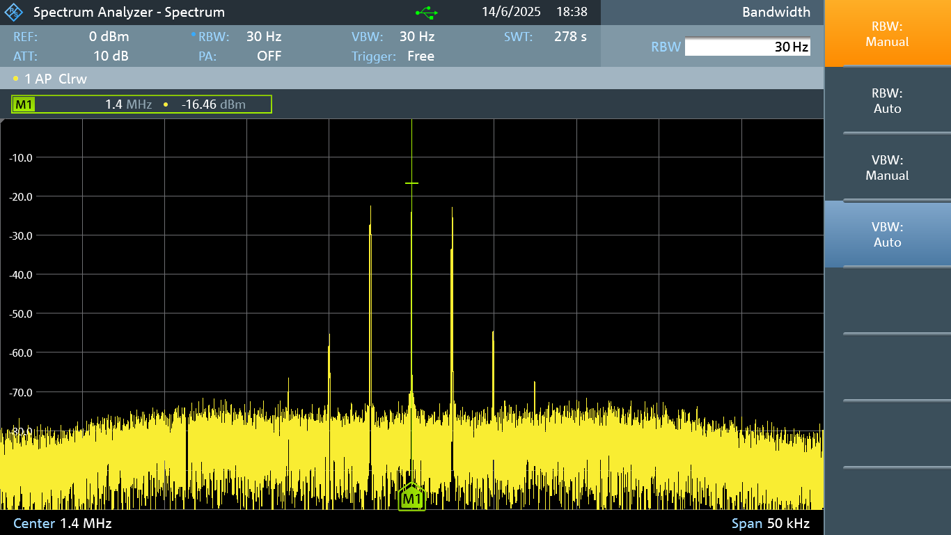

The screenshot below shows the output when configured to 632 mVp-p (about 0 dBm), and 200 mVp-p (i.e. -10 dBm). The span is 200 kHz. There’s no averaging enabled on the spectrum analyzer, so you’re seeing actual output. The output is clean, I have no complaints. It is expected for there to be some raising of the noise level surrounding the signal, and it’s not excessive.
Zooming out to see the harmonics (the screenshot below covers the range 1 MHz to 6 MHz), you can see the beginning of a pattern which will occur at any frequency setting; the output is more distorted at high output levels, compared to low output levels. You can see that the yellow output (-10 dBm) has far lower harmonics than the green 0 dBm output.

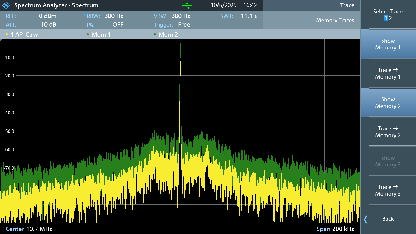

Close-in, the 10.7 MHz output looks great. Again, the green trace is at 0 dBm output (632 mVp-p), and the yellow trace is at -10 dBm (200 mVp-p).
Zoomed out (the range in the screenshot below is 10 MHz to 50 MHz), you can see some of the harmonics and other distortion and noise, but it’s low.

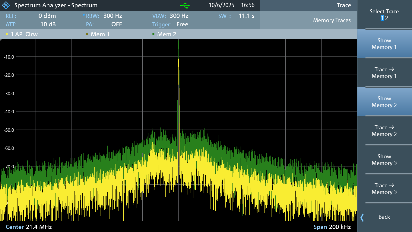

As with the other frequencies, the close-in output also looks great at 21.4 MHz. It is reassuring that the signal generator output is consistent across all the spot frequencies that were chosen.
Zooming out a bit more, you can see some non-harmonic distortion. This isn’t pretty, since it wouldn’t be as easy to filter out, and is certainly something to watch out for, since it may end up being in your desired bandwidth of interest.

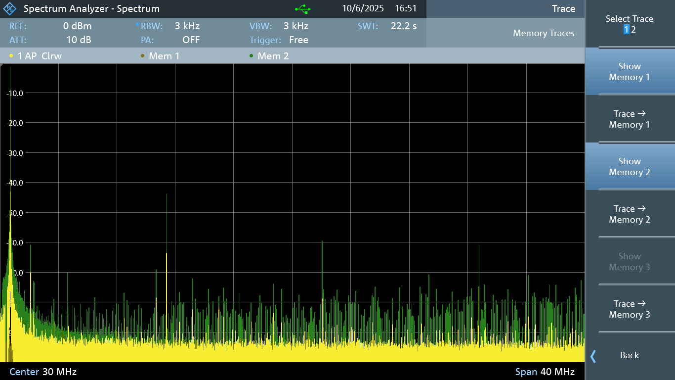

Internal Amplifier Noise
One thing that wasn’t easy to see in the earlier screenshots, is the noise beyond the supported frequency range of the signal generator. The screenshot below (which covers a 500 MHz range) shows it more clearly; you can see that when the internal amplifier is enabled (i.e. when the signal amplitude is higher than 200 mVp-p), you’ll see that green noise visible in the screenshot, versus the yellow noise when the amplitude was set to 200 mVp-p. The green output isn't ideal, but it isn’t too bad in the space of things. It’s something to be aware of.
Note that this isn’t common-mode noise, so no ferrites around the coax will solve this. It is actual noise from the internal amplifier inside the signal generator, and if it causes an issue, then you either need to drop the output to 200mVp-p or below, or a filter would need to be used. But I can imagine for almost all circumstances, that noise beyond the instrument’s frequency range won’t be much of an issue, and could always be filtered out by external circuitry if required, as mentioned. It might even be possible to modify the instrument to have a lower frequency cut-off for any output filtering, but I've not taken the unit apart and don't know if that is feasible or not.

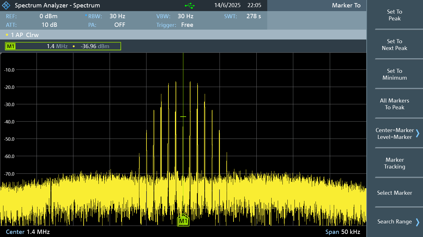

For the following AM and FM modulation experiments, I set the carrier frequency to 1.4 MHz, with an amplitude of 200 mVp-p (-10 dBm).
The DGE1030 doesn’t have an external modulation input, but you can use internal signals. I selected a sine wave to be the modulating signal.
Amplitude Modulation (AM)
The screenshot below shows a 2.5 kHz tone, with a modulation depth of 100%. It’s near-perfect.
You’d expect to see two spikes at 2.5 kHz offset on either side of the carrier, and the extra spikes at 5 kHz look incorrect, but this is really not bad; the spectrum analyzer reveals a lot since the vertical scale is logarithmic, and in reality, the power in those 5 kHz spikes is tiny, at about 30 dB lower than the 2.5 kHz offset spikes, i.e. a thousandth of the power.

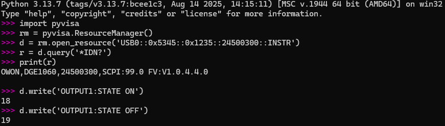

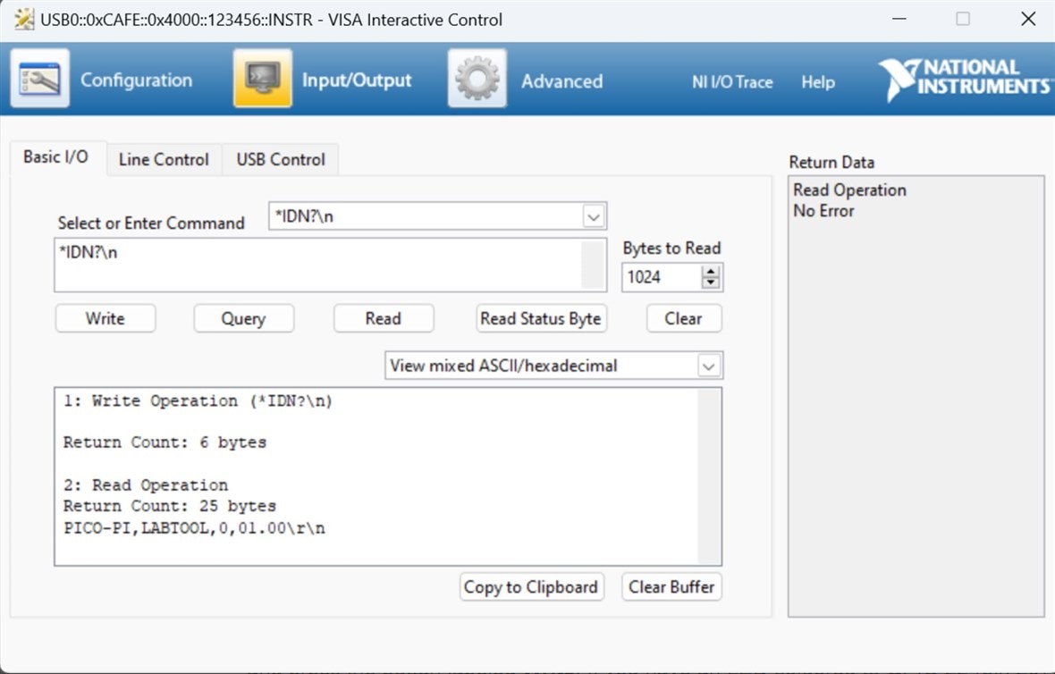

    Your suggestion to install/use NI-VISA works for me. I installed NI-VISA 2025Q3. Did not need NI Labview so far.
    I bought a DGE1060 and wanted to check out programming it.
    I replicated roughly the commands you tried and here is the output from the NI 'VISA Test Panel", all seemed to work OK:

    And from python, run in Windows command prompt (after installing NI-VISA, python from MS Store and then "pip install -U pyvisa":
    Before installing NI-VISA I tried to use pyvisa-py as resource manager, but it was (still is) not working, no idea why. Here is what happens with NI-VISA (1st run, detects the device) vs pyvisa-py (2nd run, no detect)

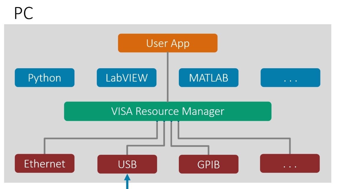

    The diagram below shows the overview. The OWON instrument connects at the bottom of the diagram, to where it's labeled USB.
    As seen in the diagram, you need a 'VISA Resource Manager" before your app (written in Python or whatever) can access it.
    They are often supplied with various test instruments, for instance if you've already got a Keysight or Tektronix 'scope or whatever, ypu may have already installed them on your PC. If you have not, then you can always download and install it from the NI-VISA website. Then you can test with either the supplied tools, or the programming language of your choice.
    There are lots of programming options, if you're using Python then the pyvisa library is used. From that link, you can see the required commands (you'll need to call open_resource as mentioned there, but with the USB identification string that you'll see from the VISA resource manager tool that got installed earlier on your PC, it may well display it in a pop-up at the bottom right of your screen if you're using Windows, or maybe within one of the apps that are supplied with it.
    I didn't write an app for it (although I have done that in the past with various instruments), I simply tested the commands by using one of the tools supplied as part of the VISA resource manager, which allowed me to type the command in a text box, and see the output.
    The screenshot below shows the tool supplied with NI-VISA, and there is a box where I typed "*IDN?\n" as you can see (this was with a different instrument, but I did the same thing with the OWON, and then typed all the other commands mentioned in the blog above, to test them out). Since it works in that tool, it will work in Python too (or any programming language that has a VISA library such as pyvisa for Python).
