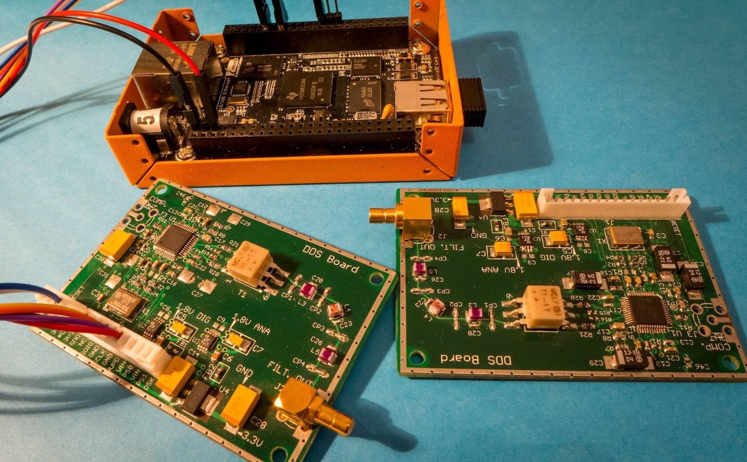

I decided to use a frequency synthesizer (check out the blog here if you wish to build one – it is controlled via a BeagleBone Black seen in the photo above in the orange case), and have been improving it over time, now it handles FM synthesis. So, it is possible to inject a single frequency or an FM signal into the SA. However, again, the signal level is too high. I needed to reduce it with an attenuator. I’d been meaning to test out a DIY attenuator for ages (I purchased the PCB from here), and it proved possible to do this using the built-in tracking generator on the SA. First, a quick look at dBm measurements and how and why they are used for measuring signals.

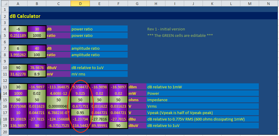

There are other points that could be made about measurements in dBm such as the fact that it is a logarithm of power and the convenience of that. Amplification and attenuation values can be added instead of being multiplied (this is a property of logarithms). Also, it is possible to learn a lot through just experimentation with numbers. There is a little decibel playbook type spreadsheet attached to this post that I created a while ago, and it is useful for quickly checking out what a particular value may mean in another unit. I don’t believe there are any bugs in it – I use it regularly for any conversions. Although there are plenty of calculators on the internet, some are incorrect.
To use this calculator, just enter a value in any green cell. The purple cells in the same column will auto-update, and then you can read off the value of interest. For example, you can see circled a scenario where the user is curious to know what 0.95 volts peak measured across 50 ohms could mean in terms of power. It can be seen that this is 9.554dBm.

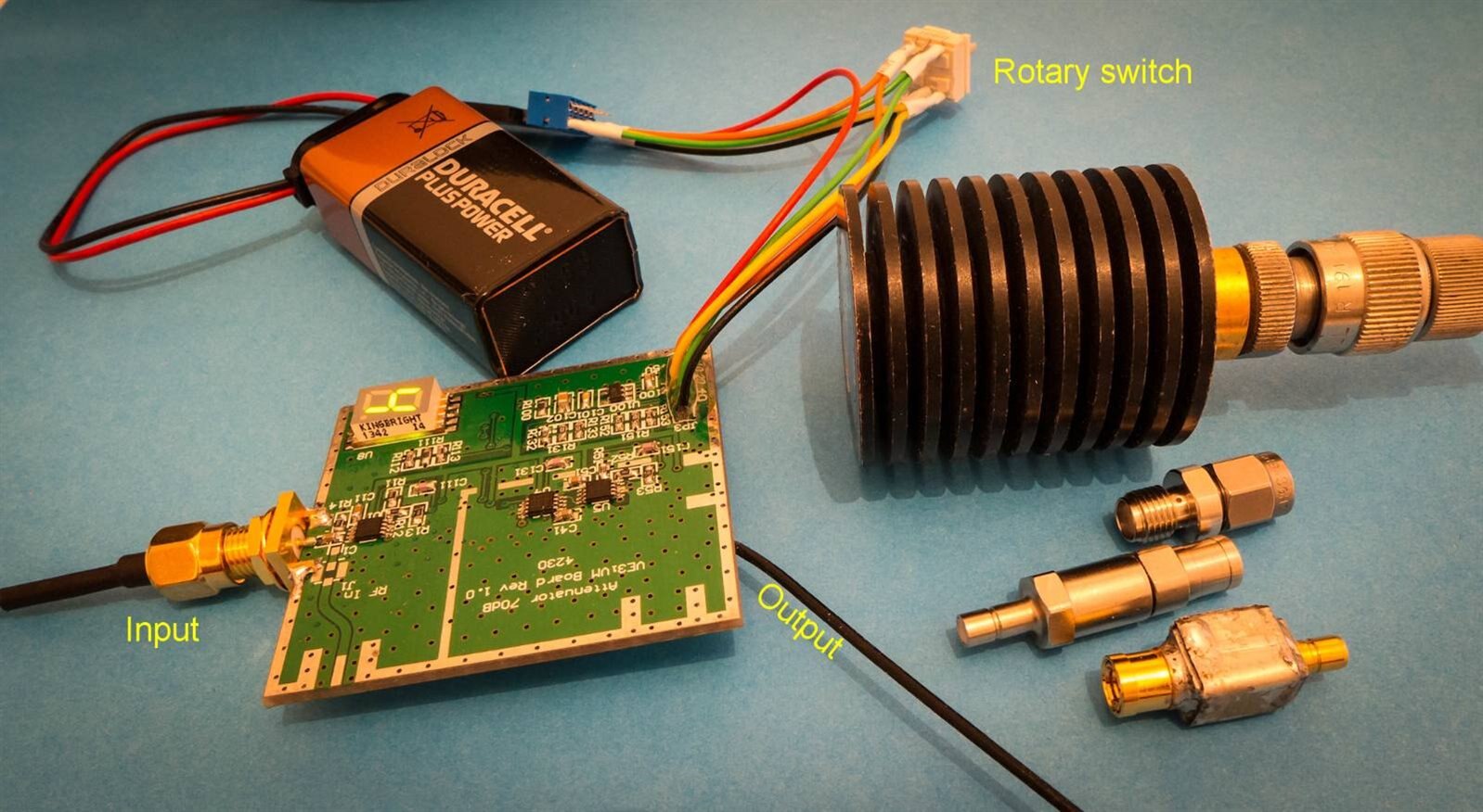

As mentioned earlier, I needed to test an attenuator to make sure it behaved as expected. The photo shows the attenuator board on the left. It is adjustable from 0dB to 70dB attenuation by adjusting a rotary switch and an LED display indicates the current setting. I need to build an enclosure for it.
On the right side of the photo, there is a 50 ohm load at the top, followed by three fixed attenuators. The bottom-most attenuator is a DIY one since it’s not economical to buy so many for home use. A lab would require precision attenuators to be purchased. To build your own attenuators for home use (but keep some known precision ones too), see this excellent page which shows the calculations for the three resistors that are needed.
As a side note, all the round connectors in the photo above are typical RF connectors; there are half a dozen commonly used varieties, and sometimes it is just down to personal preference. The threaded ones in the photo are known as SMA, the unthreaded ones are SMB, and the large one on the 50 ohm load is a TNC connector.

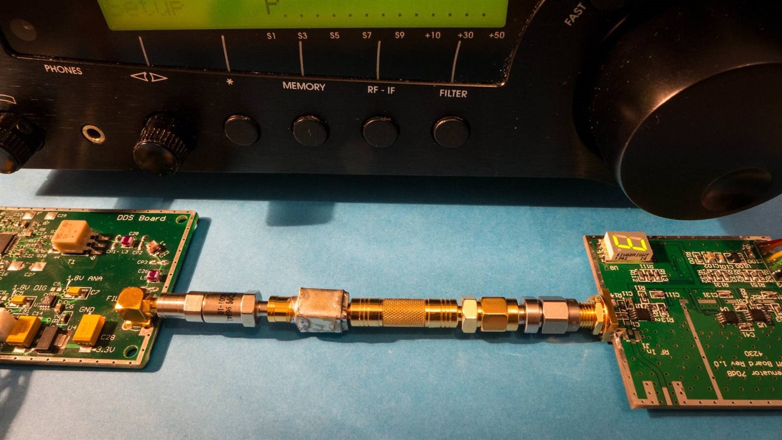

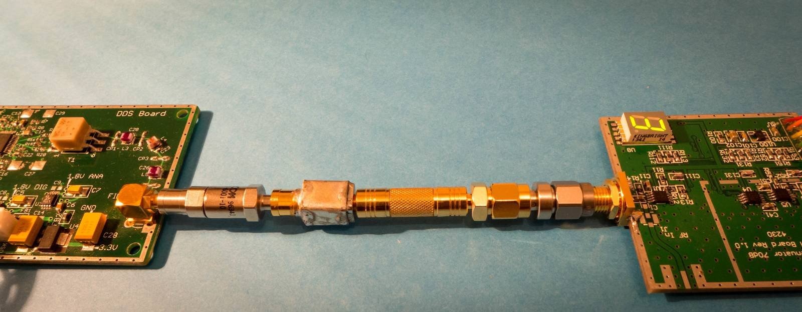

The test involved connecting the tracking generator output to the device-under-test (in my case, the attenuator) and then connecting the output of the attenuator to the input of the spectrum analyzer. Before doing this, the attenuator was removed from the system to double-check that the tracking generator was creating the correct output.

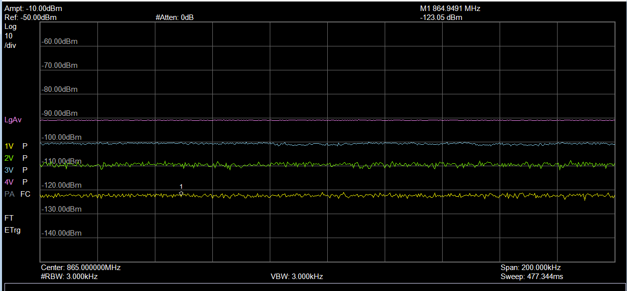

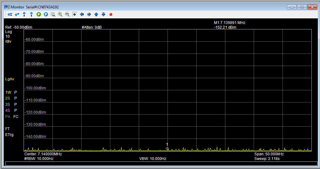

I wanted an attenuator as part of a solution to provide me a signal down to -120dBm and this is not the easiest thing in the world. It is clear that some shielding is required. Still, even without any shielding the results were quite acceptable. I tested the adjustable attenuator shown in the photo above together with fixed 40dB and 10dB attenuators all connected end-to-end so that I could reach 110dB of attenuation. The screen view below shows the attenuated signal (tracking generator set at -10dBm) for programmed attenuations of 80, 90, 100 and 110dB. It is a test at 865MHz (I only need this attenuator to function at under 1GHz).
In order to achieve such small measurements on the SA, there are a few tricks. Firstly, the resolution bandwidth (also known as RBW; this is the filter bandwidth inside the SA, partly implemented with a digital filter) is decreased to a low value. This implies that the frequency span needs to be reduced to obtain measurements in a reasonable time too. The low RBW results in a lower noise floor. I also turned on the built-in preamplifier, and set the built-in SA attenuation from -20dBm down to 0dBm. In order not to destroy anything, I always switched off the tracking generator and the preamplifier and turned back on the SA built-in attenuation, before making any change to the device under test (i.e. the external attenuator) setting. I also turned on averaging for the very low power input signals.
There is also a ‘Preset’ button which allows you to go back to default settings. I think this will be extremely useful to always turn back on the attenuation, and leave the SA in a known state again.
It is also important to check exactly where the noise floor is, when performing low level measurements. As an example, according to the SA specification, it should be possible to typically achieve around -153dBm at 1-10MHz. So, I tried it:
It really is astonishing having the ability to have such a low noise floor. There are of course SAs with lower noise floor values, but it is still surprising that -153dBm can be achieved on what is classed as a basic spectrum analyzer by Agilent/Keysight. As a comparison, the HP 8590 E-series (still in use) has a noise floor 25dB higher.
