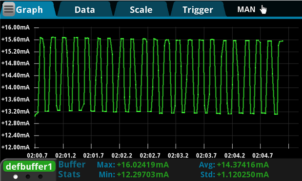

Normal mode
All examples start up in this mode.
The board blinks an LED in normal mode, so there's more than just the controller consuming power.
You could disable the LED code, but I used the graph mode here to show what's happening. You clearly see the current when the LED is on or off.
I'm interested in the controller current. So that's the current when the LED is off. Approx 13.2 mA.

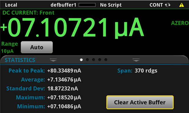

Stop Mode
In that low power mode, I measure a little more than 7 µA.

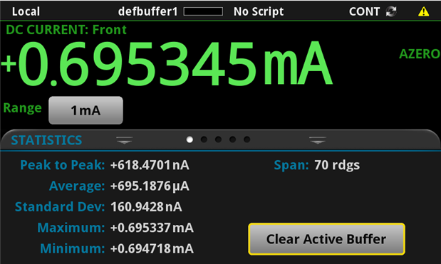

Stand-by Mode
In this mode, I get just below 700 µA.
The program behaves slightly different than explained in the readme. It stays in low power mode as long as I push the user button down.
When I release it, the controller resets. It doesn't wait for a next push.

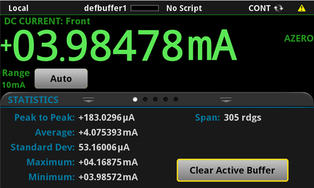

Sleep Mode
The controller takes 4 mA in sleep.
The measurements are in line with the datasheet. See 6.3.5 Supply current characteristics.
