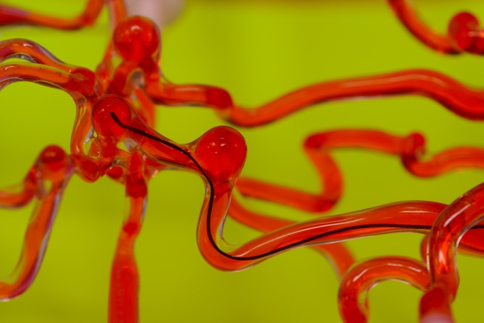

Engineers at MIT have created a magnetically controlled threadlike robot that glides through the narrow pathways, such as the labyrinthine vasculature of the human brain. Their research is published in journal Science Robotics.
The robotic thread (in black) can be steered around blood vessels in a brain by using large magnets. Researchers hope the new technology will be used in the future to clear out blockages in patients who suffered from strokes and aneurysms. (Image Credit: MIT)

The team has benefited from previous research in both hydrogels and 3D-printed materials that can be controlled by magnetism, enabling the materials to crawl, jump, and catch a ball. Researchers combined their previous work using hydrogels and 3D printed materials controlled by magnets to develop a magnetically steerable, hydrogel-coated robotic thread embedded with particles that give it magnetic properties. The snake-like robot has a nickel-titanium alloy in its center, allowing it to bend with ease while maintaining its springy form.
The engineers also demonstrated the precision and activation of the robotic thread by using a large magnet to steer it through an obstacle course of small rings, similar to moving a thread through the eye of a needle.  It was also tested in a life-size silicone replica of a human brain’s major blood vessels, which was modeled from CT scans of a patient’s brain. The team also filled up each silicone vessel with a special liquid that imitates the viscosity of blood. Afterward, the team was able to steer the robot through the narrow vessel pathways by manipulating a magnet around the model brain.
Additional features can also be added to the robot, giving it a wider sense of functionality. It can deliver drugs in the brain to reduce blood clots or break up blockages by using laser light. The team demonstrated the ability to do the latter by replacing the thread’s nickel-aluminum core with an optical fiber and discovered they could also steer the robot with a magnet and turn on the laser light when the robot reached a specified area.
