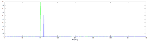

The 100Hz signal is shown in green, and the 110Hz signal is in blue in the diagram above. The frequency spectrum of the two signals can now be plotted:
C=fft(c);
S=fft(s);
plot(abs(C(1:400))/10000, 'g'); % plot 0-400Hz
plot(abs(S(1:400))/10000, 'b');
The plot above shows the spectrum from  0 to 400Hz, and the two signals can be clearly seen at 100Hz and 100Hz.

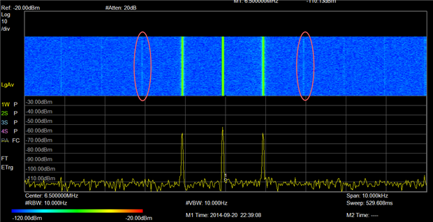

The carrier signal was generated using a DIY frequency synthesizer controlled with a BeagleBone Black. The input signal was initially a 1 kHz signal fed into the circuit through a 1uF capacitor. The output of the circuit was connected to the N9322C spectrum analyzer.
The display showed the AM spectrum. The screenshot below has 1kHz per division on the x-axis, and it indicates at the center a 6.5MHz carrier frequency, and the two peaks either side are spaced 1kHz from the carrier.
Much like with the FM analysis explored in an earlier post, the SA can also perform AM analysis. In AM analysis mode the SA shows a demodulated time-domain trace of the expected 1kHz sine wave input signal:
The alignment process involved adjusting the trimmer resistor in the MC1496 circuit while observing the modulation depth or ‘AM Depth’ value on the analysis screen, and aiming for 100%. This would correspond to adjusting from the yellow trace shown earlier to the red trace. The SINAD value was healthy, however sometimes it’s much easier seeing things using the neat spectrogram (spectrum changing over time) view:
The screenshot above shows the same three peaks that we’ve already established is the correct AM signal , however there are very faint repeated signals spaced 1kHz apart as shown circled in the spectrogram view above. These repeated signals are a symptom of distortion in either the 1kHz signal source or the remainder of the signal chain. The level is extremely low (it is in the noise in the screenshot above, i.e. one hundred thousandth of the power of the carrier). I was able to successfully reduce the level by adjusting signal and carrier amplitudes for minimal distortion.
