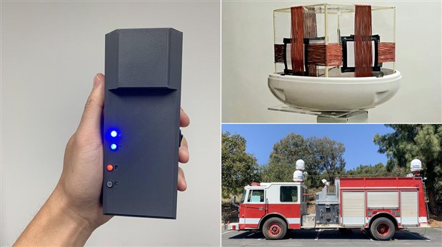

POINTER is a new tracking system to help locate firefighters inside smoky buildings. The system is made up of a receiver, base station, and transmitter. (Photo from NASA/JPL)

So how does POINTER work exactly? The system is composed of a receiver, transmitter, and base station. The firefighter wears the receiver, which is about the size of a cellphone, that communicates with a transmitter that can be attached to emergency vehicles. The transmitter will then generate the MQS fields, which will travel through the building and ping any receivers inside over a range of about 230 feet.
From there, the receivers detect the fields, determine their 3D location, and send back the data outside the building to the base station. The system uses visualization software to show where the firefighters are in the 3D space. POINTER not only locates firefighters through walls, but MQS fields can also calculate the orientation of the receiver, which can provide critical information like whether the firefighter is standing up or lying down.
