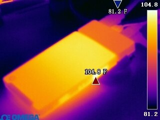

I also used the Omega TI Analyzer to see the temperature of the Kangaroo Mobile PC I used for this project. It was pretty hot after about an hour of use! (Image credit: Me)
