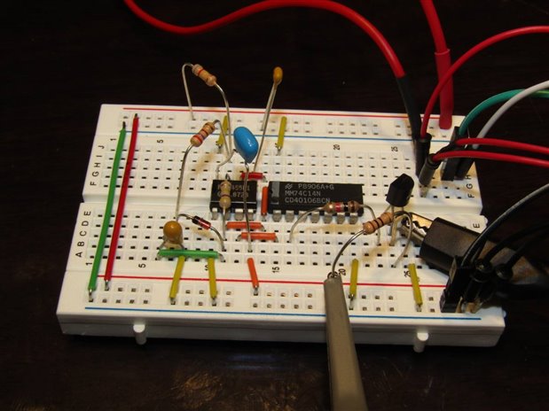

I wanted to have the flexibility to use Black in future projects so I drew up a schematic and did some bench testing finally arrived at a bread board prototype:
Here is a schematic of this circuit:
This circuit has a quiescent current of 2.5 mA and produces a 3 millisecond load of 300 mA every ten seconds. Black which would normally turn off after 18 seconds with a load of less than 75 mA was perfectly happy to stay engaged and run for hours when attached to this circuit. The 10 second load pulse was within Black's 18 second window to shut down and apparently the 300 mA load was sufficient to restart the 18 second time limit.
While I hadn't had any problems with Silver I wanted to see if Silver would also respond to the pulsed load to reset its 60 second time out on loads of less than 10 mA. Unfortunately this was not to be. The (6) 300 mA loads that were put on Silver did not change its mind and after 60 seconds it promptly turned off.

    Today I made one using a Picaxe 08M2 for the timing and used it to pulse a 2N4401 transistor with a 10 ohm resistor. I needed to use a battery pack to power a Arduino Uno with Logger (it wants 20 ma). Works pretty good with 10 millisec pulses every 5 seconds. After building it, I could have just added the resistor and transistor to the Arduino shield circuit itself and have the program pulse the resistor for me. With the Picaxe, only a few lines of code are required.
    It seems the bigger the pack, the more load is required. I tried setting up the timing for my Powobest Solar Bank and couldn't get enough current to trigger it.  Gave up on it as it would waste too much power.
