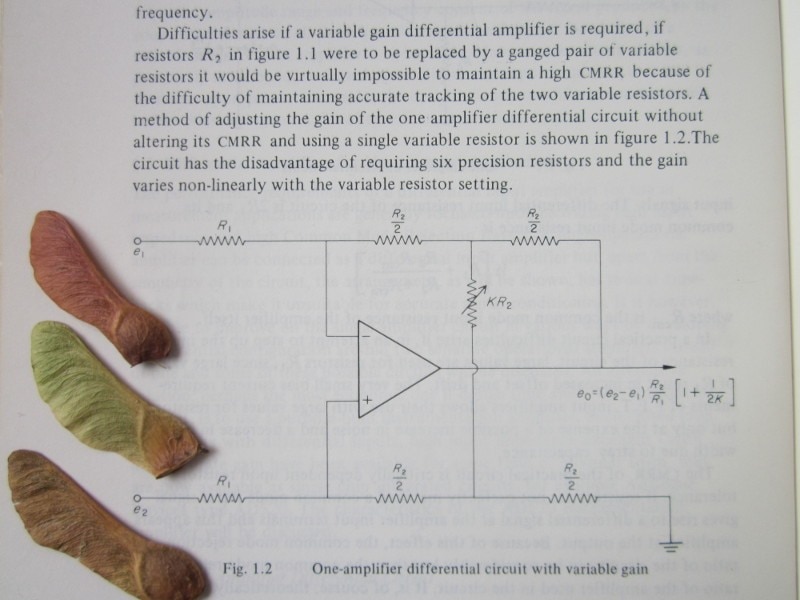

    jc2048 over 4 years ago +1
    Clayton, in Linear Integrated Circuit Applications (1975), gives this for varying the gain of the single amplifier circuit. He then follows the single-amplifier circuit, in the usual way for these…

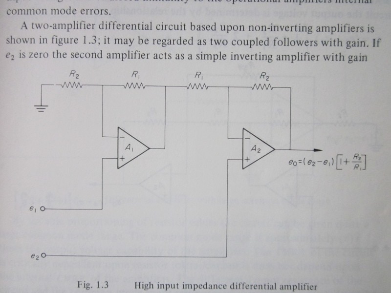

    He then follows the single-amplifier circuit, in the usual way for these kind of texts, with this two-amplifier circuit. image
    That circuit can also be adapted for variable gain with a preset between the two inverting inputs.
