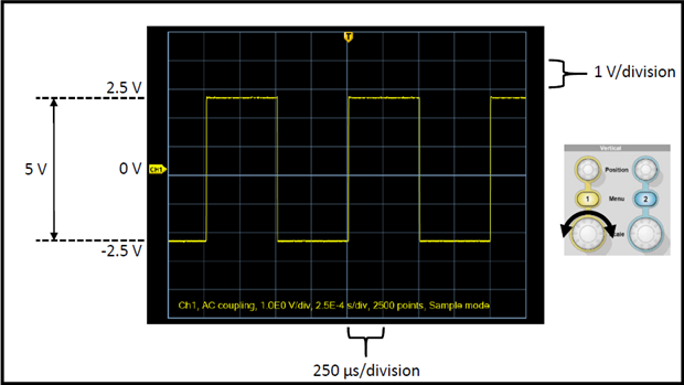

The vertical scale is controlled by a rotary knob on the unit and adjusts the number of Volts per division on the instrument. The knob for the TBS1202B-EDU is reproduced in Figure 3. The easiest way to explain something, sometimes, is to just give an example. In Figure 3 I have reproduced a square wave captured by my TBS1202B-EDU. On the right side of the figure I have shown the vertical scaling as 1 Volt per division. For every division on the vertical scale (up and down) 1 Volt is represented. Looking at the left side I have shown that there are 5 divisions in the amplitude of this waveform, and it, therefore, spans 5 Volts. I.e. 5 divisions at 1 Volt per division is 5 Volts. The channel 1 marker on the left side shows where the 0 Volt level or ground is located.
Figure 3: Square Wave Captured on the TBS1202B-EDU with 1 Volt per Division.
