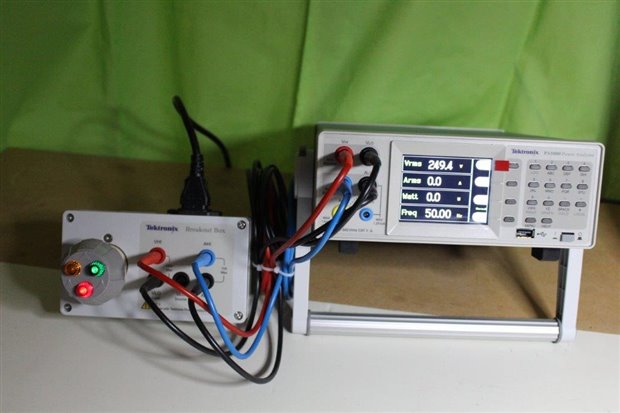

Figure 1 - Equipment set up (Back: Variac, Isolation Transformer, PA1000 Power Analyser, Front: BB1000-NA breakout box)
Many thanks to Tektronix and element14 for giving me privilege and opportunity to road test the Tektronix PA1000 Power Analyser.

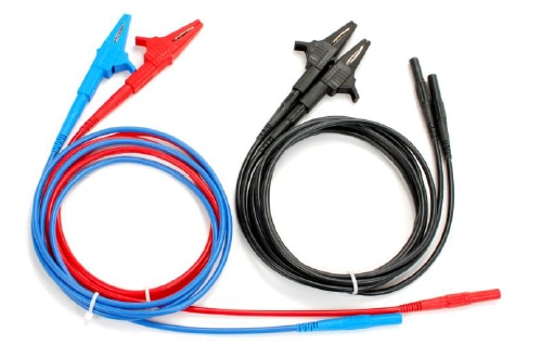

Figure 2 - The supplied Test Leads with alligator clips attached.
The PA1000 is supplied with a set of 1000V, 32A Cat II, UL 61010 complaint Test leads with removable alligator clips, software and manual CD and accompanying paper work including a calibration certificate.

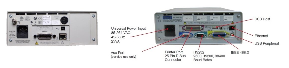

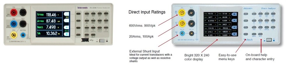

Unlike standard OEM branding where the only changes are just cosmetic changes the PA1000 and BB1000 Breakout box accessories have been modified. The USB Type A host port for hosting a memory stick has been moved from the rear panel to the front panel. The parallel printer, serial and service ports have been removed from the rear panel. The GPIB port, Ethernet port, USB Type B port and earthing attachment point remain but are in different locations. The front panel external shunt connections and sockets have changed. The colour of the 4mm input sockets have changed to red, blue and black to align with the breakbout boxes for clearer interconnection and the PA1000 now contains two internal current shunts - the original for normal range (1A-20A) and low range (< 1A) that was previous contained within the Voltech breakout box.

Figure 5 - Front Panel comparison
Figure 6 - Rear Panel Comparison

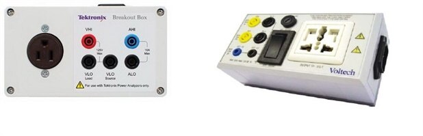

The original Voltech Breakout box was a universal power standard design that contained a switchable low range current shunt.  Rather that doing the same Tektronix has released 3 different versions of breakout box designed specifically for the North American, European Union and United Kingdom domestic power connector standards. These new breakout boxes are colour coded to match the Tektronix PA1000's new terminal colours and do not contain a switchable current shunt because it is now contained within the PA1000.
Figure 7 - Breakout Box Comparison
I received a North American version of the breakout box (BB1000-NA) and I needed to open it up and check its suitability for 230VAC because its attached compliance labels specify a maximum of 125VAC @ 50/60/400Hz. Interestingly the internal wiring uses the EU (& UK) colour code standard with Brown for Active, Blue for Neutral, and striped Green/Yellow for Earth. The IEC 320 input power connector system ensures that the power signals are connected up to the correct terminals. A compliant travel adapter used must ensure that the output socket pins remain correctly wired ensuring that Active is still connected Active, Neutral is connected to Neutral and Earth connected to Earth. For the case of an Australian plug conversion to USA plug (in fact the same for EU and UK) the physical positions of the Live and Neutral must be transposed.

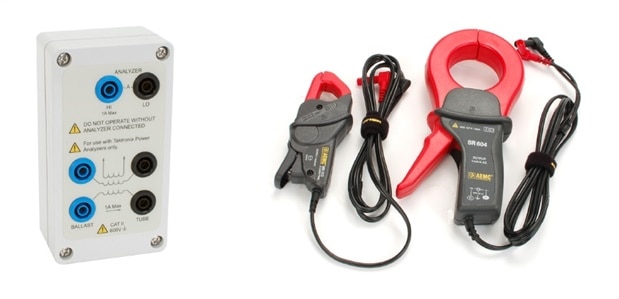

Figure 9 - Ballast Breakout Box and Current Clamps
There is a range of accessories for the PA1000 to allow it to be used for a large variety of conditions. This includes a specialty current transducer for lamp ballast testing and two current clamps to handle higher current ranges 200A and 1200A. Unlike the breakout box and standard connections these optional current clamps connect to the external shunt input terminal.

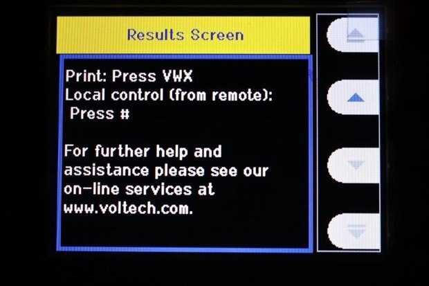

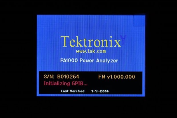

The Tek.com website for the PA1000 was browsed and updated firmware, firmware updater and the PWRWARE application downloaded and installed. The PA1000 Firmware was brought to version 1.001.006  (The help screen reference to Voltech was xxxx).

Figure 10 - Updated Caption Screen showing new firmware level but no new logo.

Figure 11 - Updated Help screen now referring to www.tek.com

To confirm a safe connection prior the connection of any device I connect my plug wiring tool to confirm that the wiring is safe. This requires the mains power to be switched on for the test and switched off prior and after the test.
Figure 12 - The illuminated Green and Red indicators confirming correct power wiring and ready for testing.
