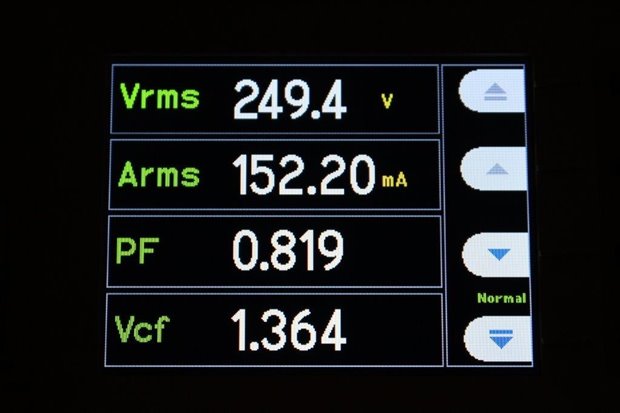

Parameter Mode
Figure 13 - Four Parameter Display Mode
By default four parameters are displayed on the LCD with an aesthetically pleasing and easy to read font.  If more than four parameters have are being tracked the up and down buttons can be used to scroll the display. If one finds this display mode awkward the number of parameters can changed between either four or fourteen (albeit in a smaller font) using the menu options.  The procedure to do this is not intuitive and requires quite a number of button presses.

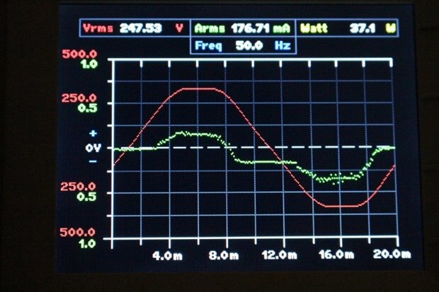

Graph Mode
Figure 15 - Graph Mode displaying input voltage, current and their interrelationship
The graph mode is very useful and provides information graphically for fast interpretation. Input wave forms such as voltage and current the graph auto scale to show a single wave starting at zero in both X and Y scales. From this it is very easy to identify any phase shift with voltage and current. The graphs and their annotations are colour coded with the colour to match the captions across the top of the display.  Red = VRMS, Bright Green = ARMS, the Blue + & - don’t seem to have any real meaning.
Although the photo does not convey the difficulty I have reading graphs with the small screen. This can be overcome with connection to a PC via the PWRVIEW application for a much larger display.

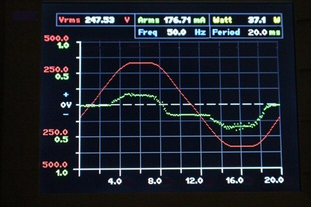

To me there are a few confusing points of the graph. The first is the top X-axis scale. Why is it there? The second is that the time scale is devoid of any unit symbol and the third is the blue plus and minus symbol surrounding the origin.  I think this confusion can be alleviated by removing the top X-Axis scale, having a period value displayed in the caption area and removing any time unit prefix scales from the time scale annotation. Below is a mock up to illustrate my point.  To me this looks clearer but it is just a personal preference.
Figure 16 - My Graph display mock up
When performing real time logging the graphs are plotted incrementally as the values are encountered but I did notice that the graphing function algorithm used to set the pixels appears to have a rounding bug. For some graphing there are noticeable gaps in the X-axis for a supposedly continuous curve. (Note: These gaps are not present when the data is exported to PWRVIEW.)
A zoom function would be greatly appreciated so the technician can have a closer view of the area of interest such as a close up of any present ripple.
When displaying logging graphs of voltage, current or alike there is no obvious warning that the system is not in Integration mode. The display just sits there remaining inanimate. It would be good to have a nice friendly warning message pop up informing the operator of their error.
