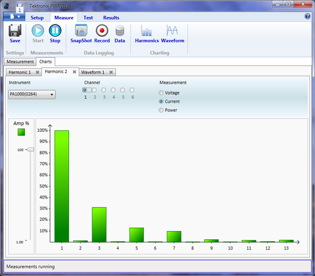

Figure 25 – Current Harmonic Graph
There are quite a large range of forms and graphs and all are useful for diagnostic purposes. Pictured above is a Current harmonic graph of a Notebook SMPS (Switch Mode Power Supply) and from it one can see that it would not have great PF (Power Factor).
For development one would want to only have the fundamental frequency present.  This alone is not enough to ensure a good PF. The current signal should be in phase with the input voltage. Details of this can be seen from the Waveform view where one can see the phase relationship between current and voltage. It can bee seen from Figure 24. that the current is in phase but the wave form is non-sinusoidal.
