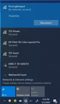

To insure that my RPi4 used its own hotspot all the time, I removed all of the known networks from wpa_supplicant.conf.

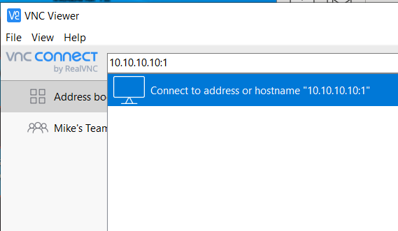

Because not everything goes as planned, the IP of the hotspot is 10.10.10.10.  When wirelessly connected to the hotspot with a laptop, I used PuTTY to log into the RPi4 and start the VNC server.  From there, I was able to use RealVNC to launch and run the PicoLog 6 software.

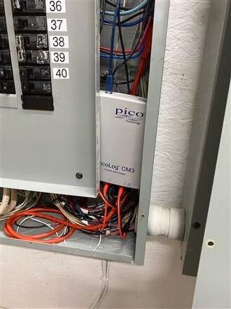

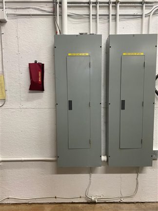

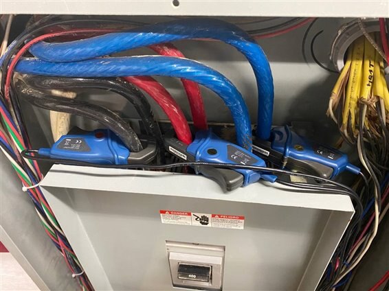

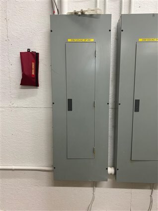

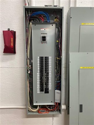

Starting point.  Those are compact fluorescent lights on the left panel.  I really need to do better housekeeping.  Remove panel face.  Add current clamps.

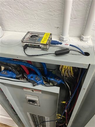

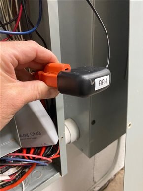

The RPi4 is going to need power.  Fortunately, there is a spare breaker in the panel.  Add convenient plug.  Connect clamps and USB.  Place CM3 neatly in cabinet.
I did choose to pop out one of the knockouts instead of trying to sneak the cables from beneath the cover.  Add cover.

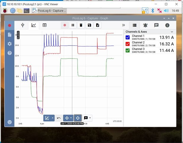

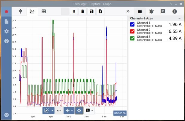

Turn on circuit breaker and power up the RPi4.  Go fetch laptop.  Join RPiHotspot - which I renamed PicoLogHotspot.  I'm still not having any luck auto-starting the VNC server.  It did for a while and now it doesn't.  So, PuTTY to the rescue.  SSH in.  Launch vncserver.  Log in with RealVNC.  Launch PicoLog 6.
Here's what the data log looks like after about an hour and over night.  I did have to go back and change the scaling on the current clamps when I first started, but I only lost 2 or 3 minutes of recording.

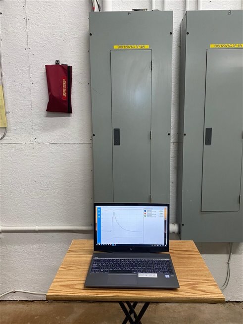

I snapped this while sitting at my desk 30-ish meters from the panel.
The PicoLog CM3 AC Current Data Logger is quite versatile.  The average person wouldn't even notice the Raspberry Pi on the cabinet.  THIS is exciting stuff - at least to a generator nerd.
