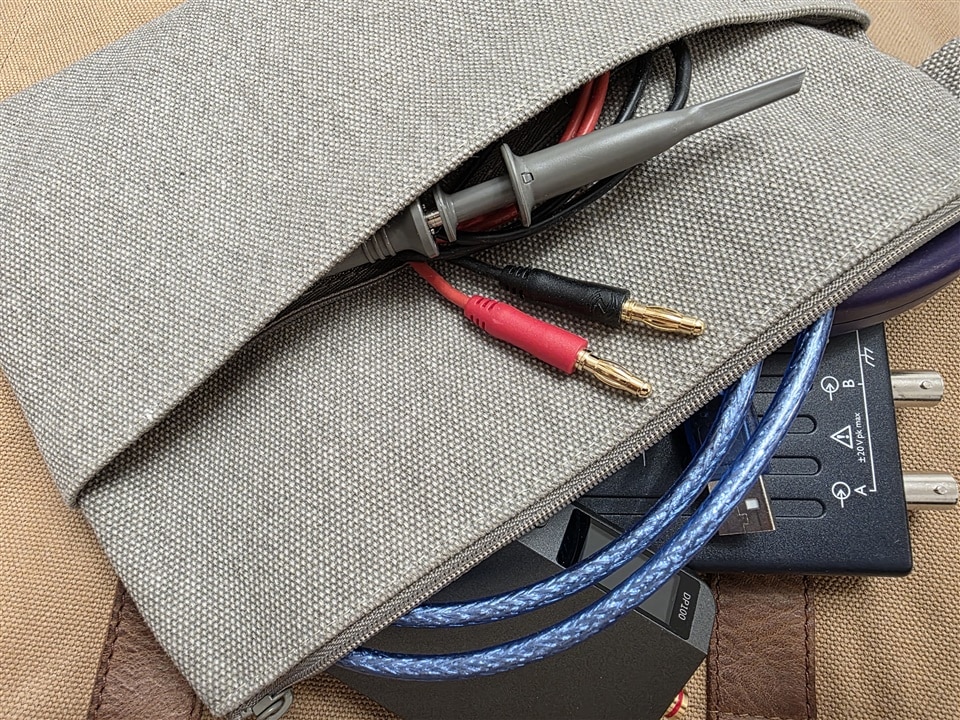

It’s so small, I have time-domain, frequency-domain and signal generation capabilities from the PicoScope, plus a power supply, ESR meter, various USB and banana cables and a couple of ‘scope probes and other ancillaries, in one little zipped travel wash-bag!

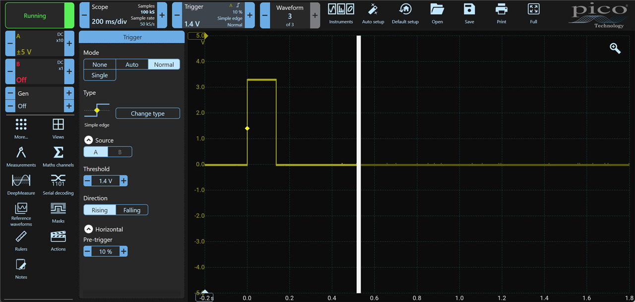

The screenshot here shows a typical view in dark mode. I was troubleshooting why my 3.3V UART signals were at 2V! The serial decode was nice and clear to follow.

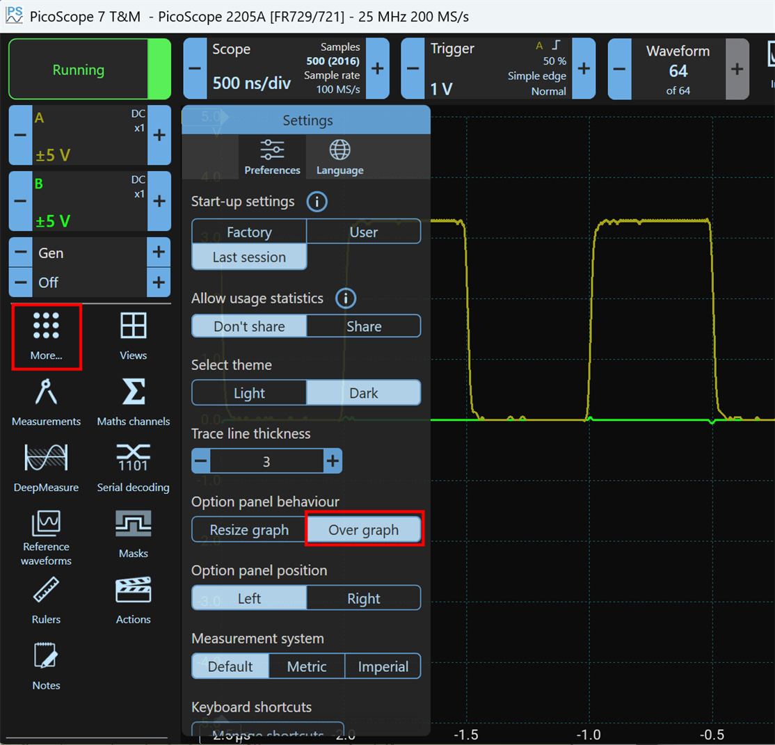

What I found extremely annoying, is that any side panels that pop into view automatically can collapse away when the trace (chart) area or the top icon pane is touched. It’s very disconcerting that the chart area resizes when your attention is elsewhere and not on the pane that’s just disappeared. I should record a video showing this sometime, but it’s really not nice. I think the manufacturer should test more regularly with tablets, to spot these sorts of usability issues.
I really like that you can set the trace width, so that the trace isn’t so fine in high-res. I don’t recall if that was possible in PicoScope 6, but I’m glad I found it in 7; I’ve got the width set to 3 instead of 1, and it looks great on my laptop screen. By the way, the Settings are hard to find; the cog icon is buried within a “More…” icon! I would have expected the cog to be prominent on the top toolbar.

A really nice usability touch is that when triggering with really slow timebase settings, a vertical bar slides along with the trace, and halts at the trigger location.
And then when the trigger event occurs, it slides along : )
It’s really neat, has to be seen to appreciate it. There are some minor bugs, the software did crash for me a couple of times, but it prompts to send a report to Pico, so the manufacturer should already be aware, with no effort needed for me to create a problem report manually.

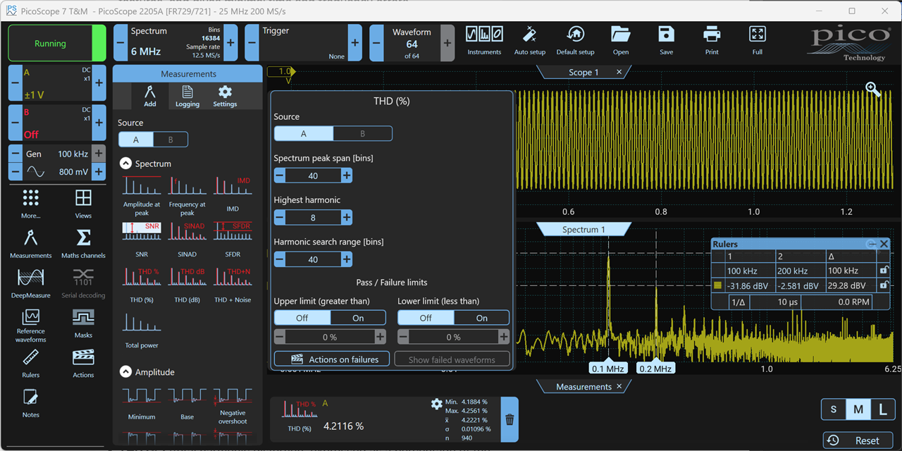

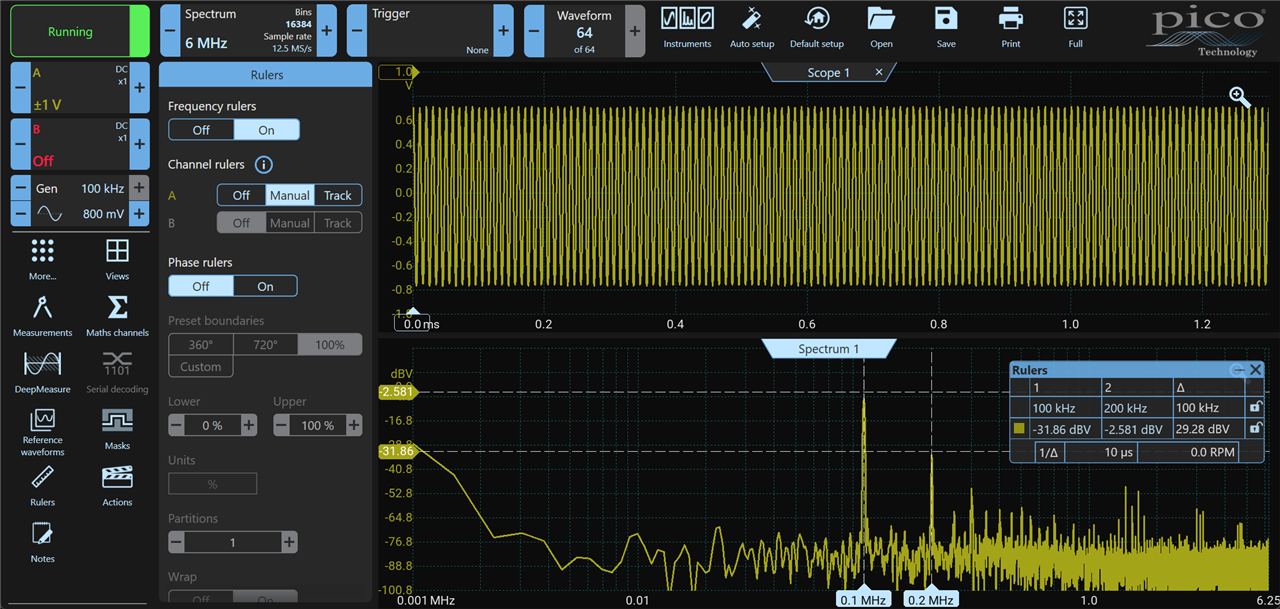

Spectrum View
In the frequency domain, I have been spoiled by Rohde & Schwarz and Keysight desktop instruments so nothing is going to compare (although, having said that, Pico Tech have been developing frequency domain products in recent years, such as a VNA, so perhaps their roadmap will fill out this area). In general, the spectrum view is for sure usable. I’m unclear if I would see more features if I have a better/more recent PicoScope. However, it’s extremely impressive that the old 2000 series still allows one to get quite usable results.

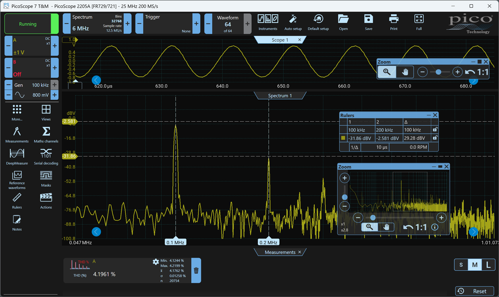

I found the user interface a little confusing, I spent the best part of half an hour trying to locate where the spectrum settings were (and the user manual didn’t help as much as it could have). What was confusing me, was that the left pane has a View icon, that allows a spectrum view to be added, but the configuration of that needs to be done from the Instruments icon at the top pane. The Instruments panel allows one to switch from some oscilloscope configuration elements, to spectrum configuration. In the screenshot below, you can see at the top the spectrum settings are displayed where some of the scope configuration (timebase, acquisitions etc) were previously shown. The Instruments icon is used to switch between the settings. I’m OK with that, but it was quite hard to initially figure out.
There's quite a dichotomy in terms of spectrum features. On the one hand some "normal" spectrum features are missing, such as the ability to simultaneously display the peak as well as the normal trace, or to freeze the spectrum trace as a reference overlay and so on. Markers are not really implemented, just very manual cursors. And yet on the other hand, measurements can be added to the spectrum and then there's a wealth of additional capabilities, and dead easy to use. I didn't expect to be using such a low-cost, old instrument, and still be able to use it for measuring distortion! (Sure, I cannot use the 8-bit instrument that I have for Hi-Fi, but I can certainly see major anomalies that would be difficult or impossible to discern from the time-domain).
In general, I think the core spectrum functionality is there and it works pretty fast even with my ancient PicoScope, since the PC is doing all the mathematics to convert from the time domain. It’s very usable, I love the measurements, and I can always “print screen” and manually compare at ease on the large PC screen, or even perhaps write my own app if I ever have a niche requirement - I'd probably upgrade my PicoScope to a higher-res one at some point too.

    This was driving me nuts.. every time any config was changed, a pane would appear, and it would cause the main waveform view to resize, to fit the new pane.. and then again it would resize back to where it was, when clicking inside the main waveform area. Amazing how irritating that was, because you'd lose focus because the signals would visibly squish and then stretch back out.
    The solution is easy but hidden... click on More, then click on the Settings icon (cog), then there's an "Over graph" option, and simply enable that. Now the new pane just floats on top without resizing things. And then, since one tends to want to view the left side of a waveform more closely than the right, it's best to select "Right" for the Option Panel Position, rather than the left side, so that the floating pane comes in from the right. Can't believe these things were not the default.

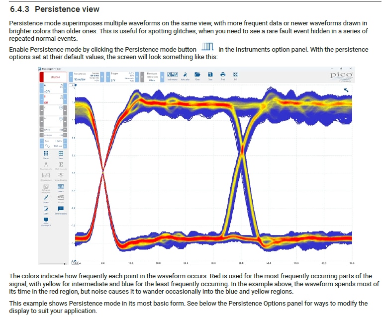

    shabaz 4 months ago in reply to kk99

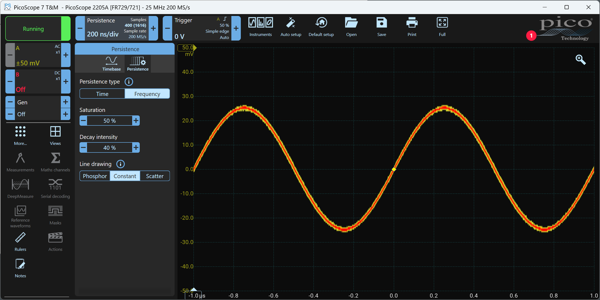

    I just gave it a shot too, it does support persistence as Michael mentions. Looks pretty good too, even on the basic PicoScope I've got. However, it's a special mode (a bit like some desktop 'scopes supported it at one time), notice a lot of the toolbar on the left is grayed out. Still, it's very quick to flip back and forth between 'scope and persistence. However, there's a bug there somewhere; I've made the software lose awareness of the attached hardware (even after restarting the software, and re-inserting the PicoScope; it need a full PC reboot! but I've let the software submit a bug report, and I've contacted the mnfr via their online form, since this bug impacts productivity quite a lot. It would be interesting to see if michaelkellett sees the same issue. I'm not sure of precisely how it's done, but I flipped between 'scope and persistence a couple of times, and also turned on a measurement (because I wanted to see if the measurement was preserved after switching back out of persistence mode).
    Anyway, once that bug is fixed, I think I'd be happy with the persistence mode, but I would like to suggest that the measurements are preserved when the user switches back to normal.

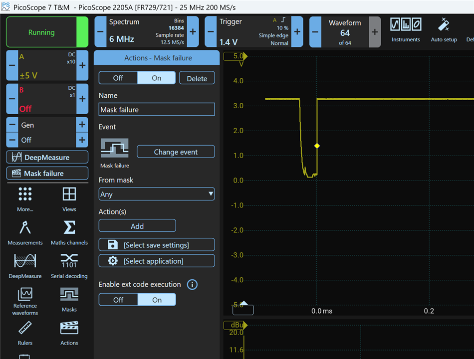

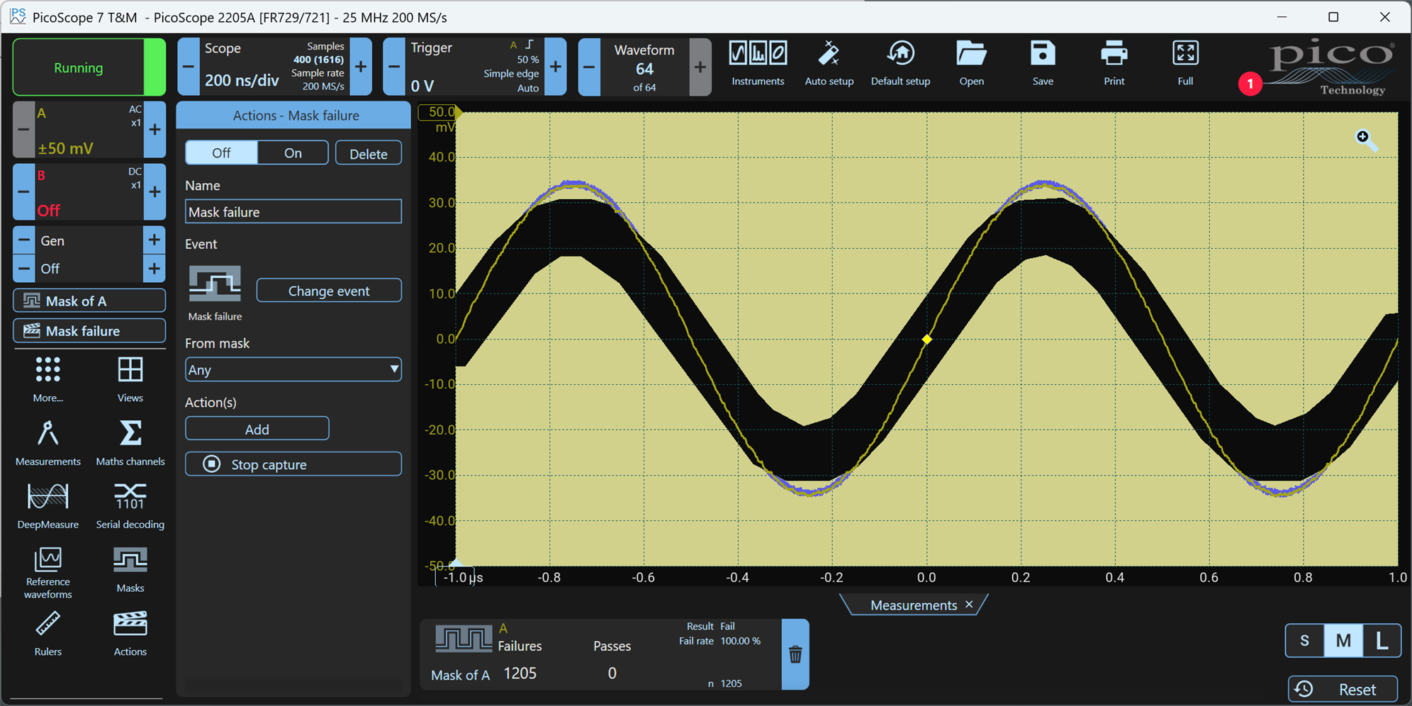

    I don't think it supports a zone trigger as such, but there are other features that would probably do the same thing for a lot of circumstances. There's a window+time interval trigger and an end-of-pulse-train trigger for instance, they both seem super-useful. Also, not quite the same as a trigger, but it's possible to use a mask+action to capture things. I know it's not a replacement, but depending on the scenario often there's more than one way to skin a cat.
    For example, here's a mask created from the waveform, but one could design their own I think, since it's possible to save and load them. I've not checked the user manual, but it wouldn't surprise me if this is something possible to program up.
    And then with an action added, it will automatically freeze the trace (and also e-mail you or whatever, since it can trigger any software).
