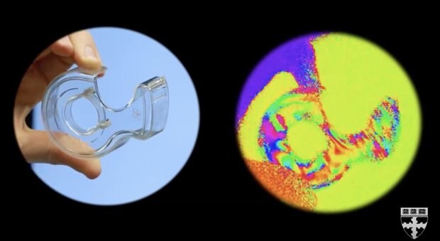

The polarization camera gives us a glimpse of normal vision on the left and what vision is like to an insect or shrimp, on the right. (Image Credit: Harvard)

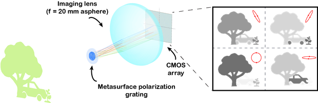

The polarization camera uses an array of nanopillars to beam light on an object, creating the polarization effect. (Image Credit: Harvard)
By using a new technique on how polarized light interacts with materials, researchers were able to build a metasurface that uses an array of organized subwavelength spaced nanopillars to beam light due to its polarization. Afterward, the light creates four images that show how conditions differ to the polarization. When the images are taken at the same time, a full snapshot of polarization at each pixel can be observed. The special camera is only two centimeters long and has the same level of complexity as a smartphone camera. It contains an attached lens and a protective case. When testing the camera, researchers used it to view deformities in injection-molded plastic objects, used it outdoors to capture the polarization off car windshields and took facial snapshots to show how the camera can picture the 3D curves of a human face.
