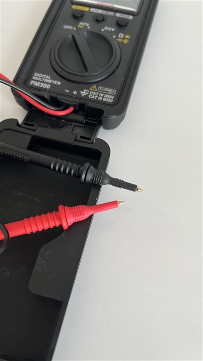

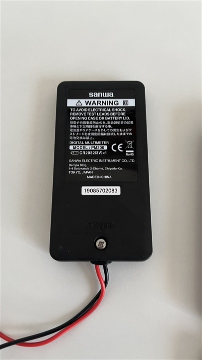

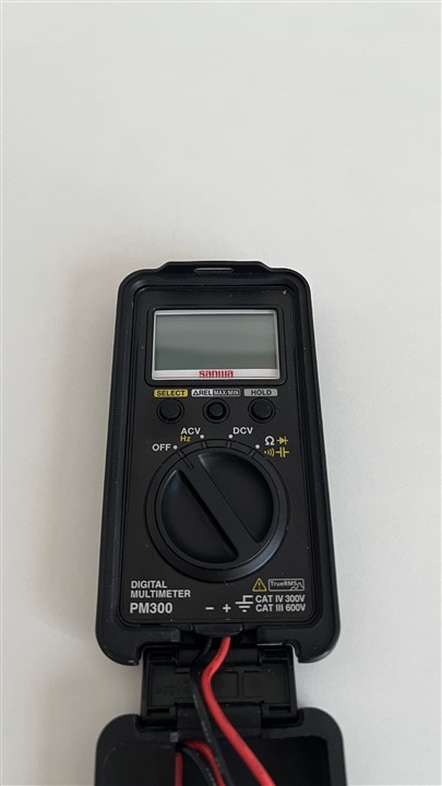

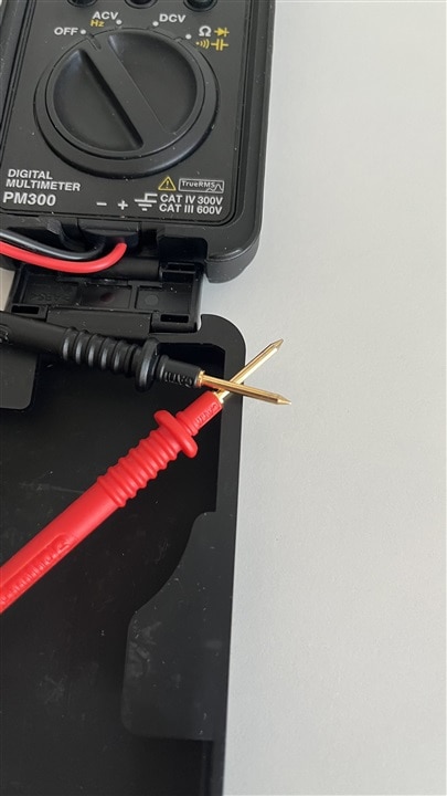

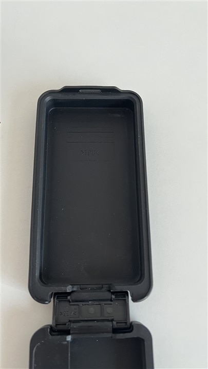

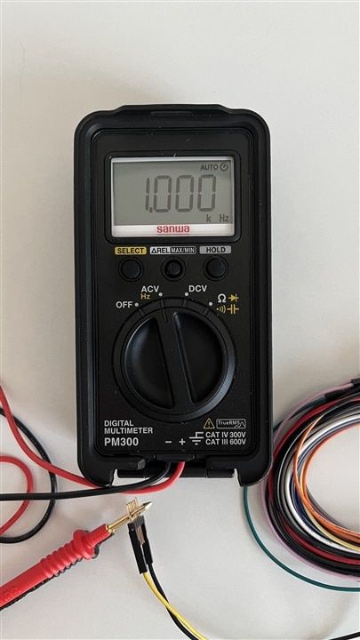

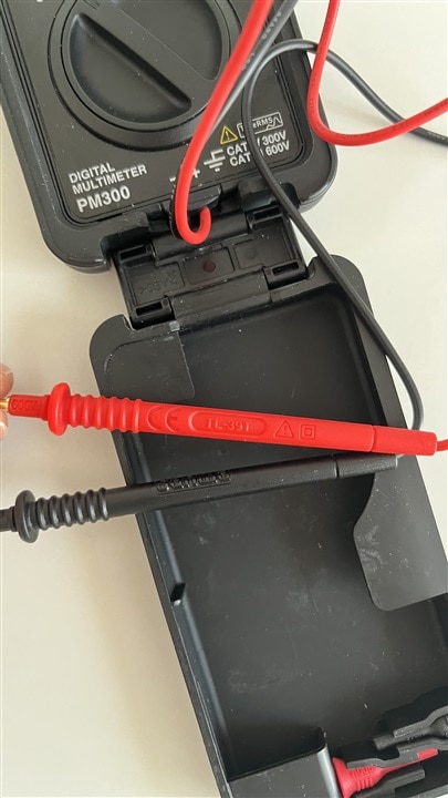

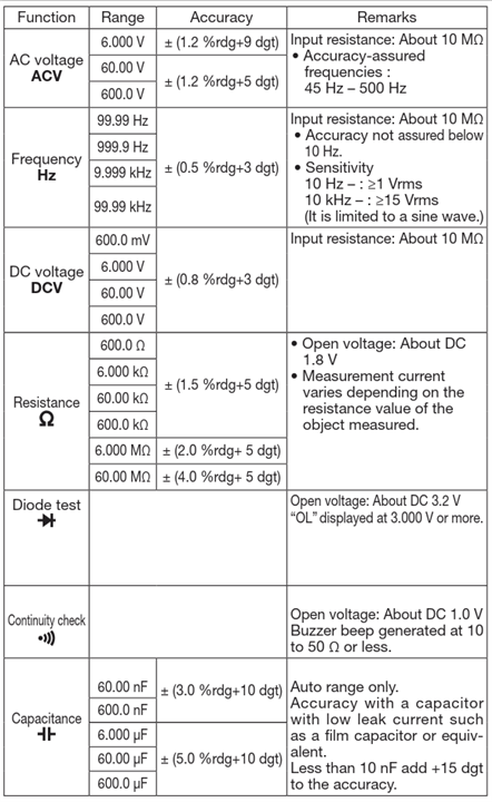

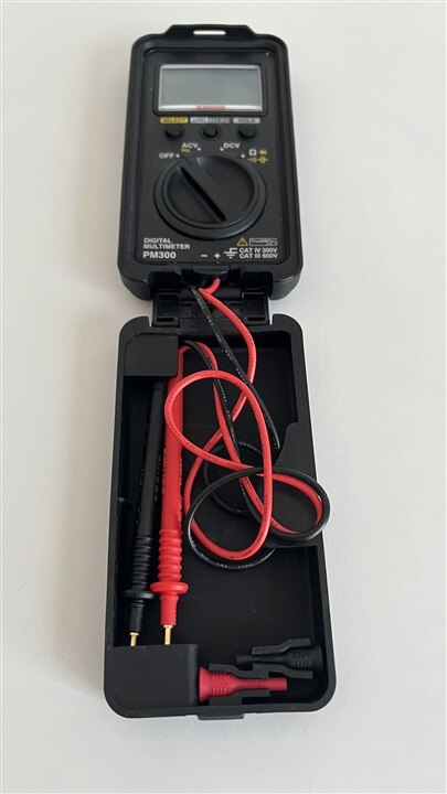

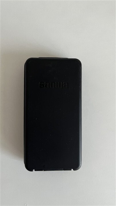

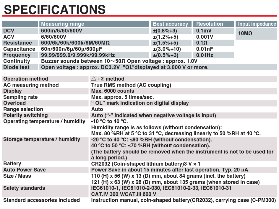

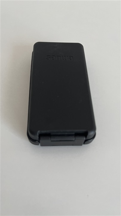

A few years ago I looked for a replacement for my portable multimeter, the Appa iMeter 5, for which I was not fully satisfied. I have found a Sanwa PM300. I have been using it till now, and I am very happy with it. The quality of build is better in comparison to the Appa, it has a really good case. The test probes TL-39T are also very good and have removable test pin covers, which reduce the unshielded area of the pin. Additionally, it supports True TrueRMS on ACV. The only drawback is the lack of the current measurement, but it was really limited in the case of Appa. Below there is specification of Sanwa PM300:
Here is a more detailed specification from the user manual:
The specification as for a multimeter that can fit in the pocket is reasonable. I have performed some tests to show how it behaves in real usage.

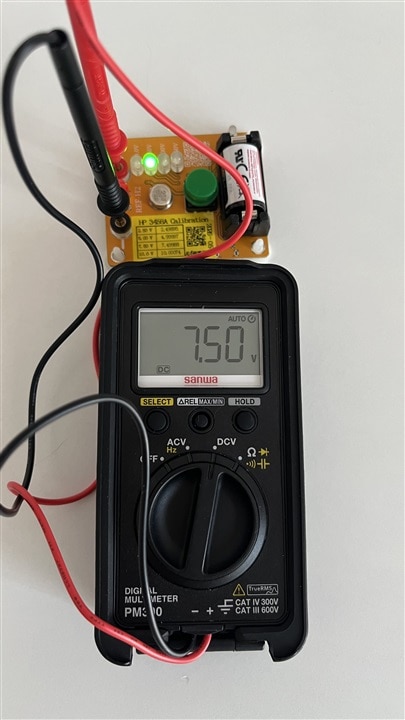

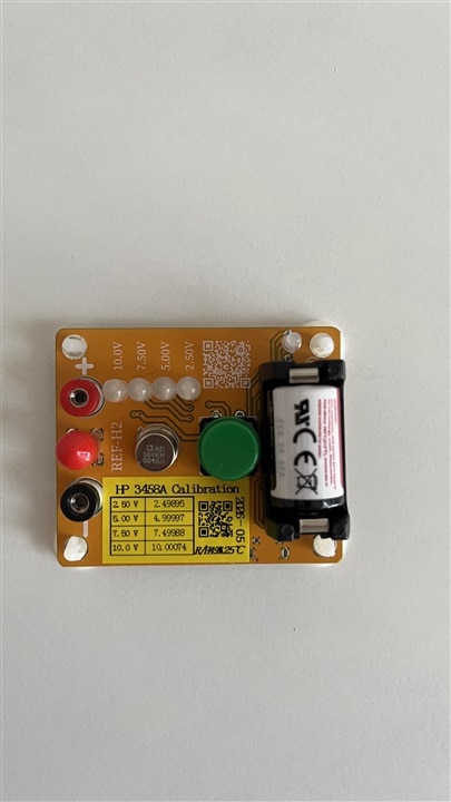

The first test was to check DCV with usage of the AD584K voltage reference. Below the results:
{gallery}DCV test
Voltage reference AD584K
Measurement of 2.5 V
Measurement of 5.0 V
Measurement of 7.5 V
Measurement of 10.0 V

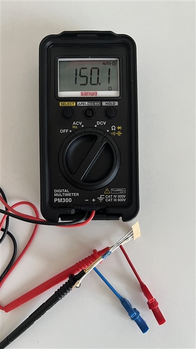

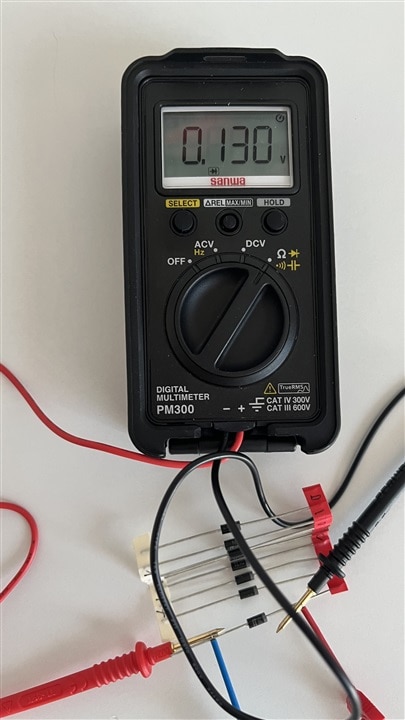

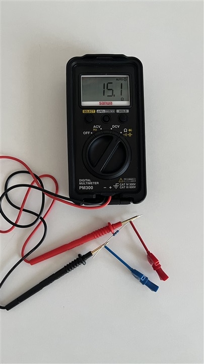

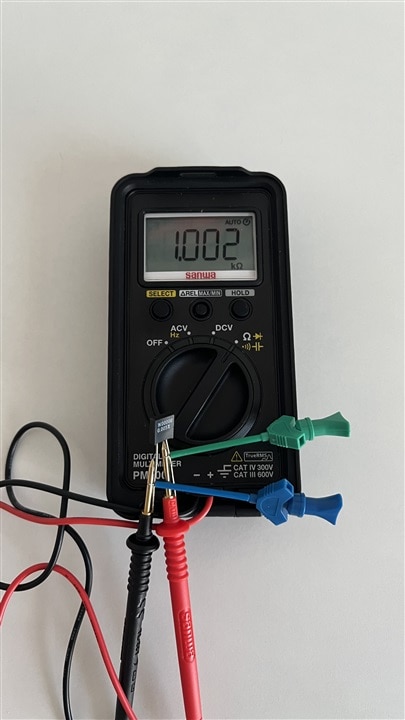

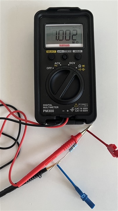

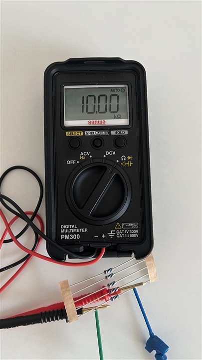

The next test was related to the measurement of precision resistors: one of 0.005% and the rest of 0.1%. Below there are results:
{gallery}Resistance test
Measurement of Vishay S102CT 1 kOhm 0.005% 2ppm
Measurement of Vishay 10 kOhm 0.1% 25ppm
Measurement of 1 MOhm 0.1 %
Measurement of 150 Ohm 0.1%
Measurement of 15.1 Ohm 0.1%

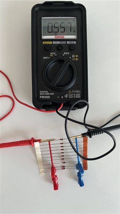

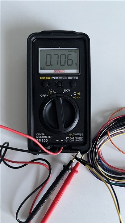

I have also performed a quick check of some diodes. Below are results:
{gallery}Diode test
Measurement of 1N5817
Measurement of BAV18

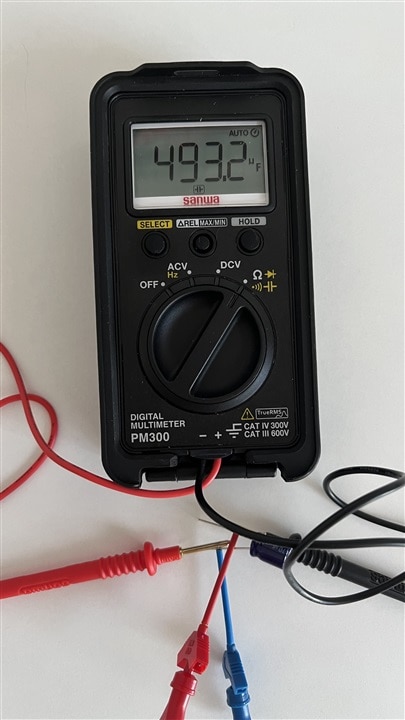

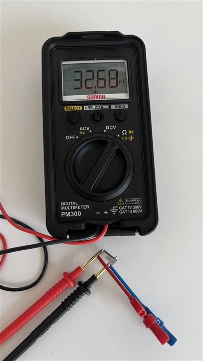

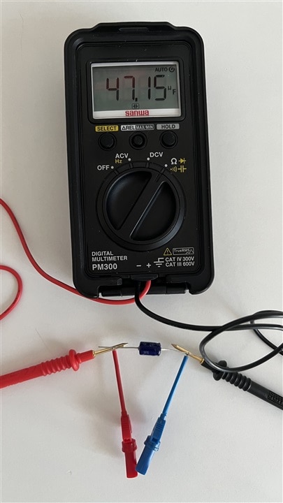

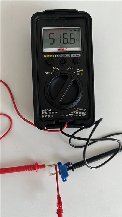

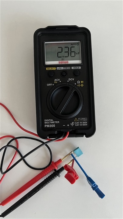

I have also checked the capability of measurement of capacitors. Below there are results:
{gallery}Capacitor test
Measurement of 470 uF 16 V
Measurement of 47 uF 35 V
Measurement of 470 nF 63 V
Measurement of 33 nF 250 V
Measurement of 2.2 nF 400 V

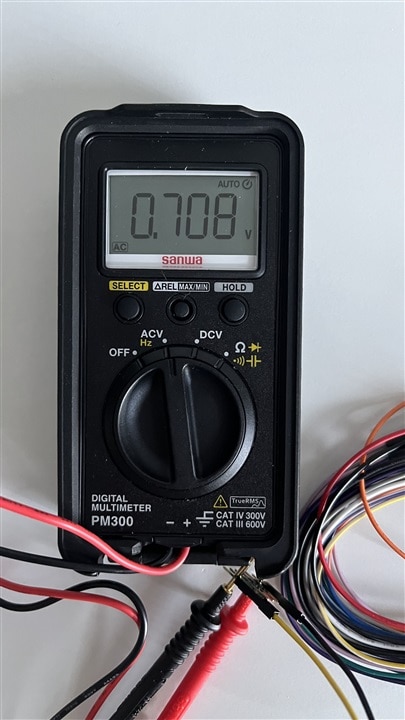

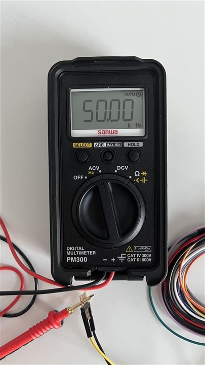

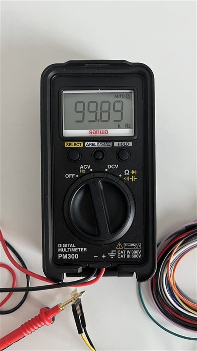

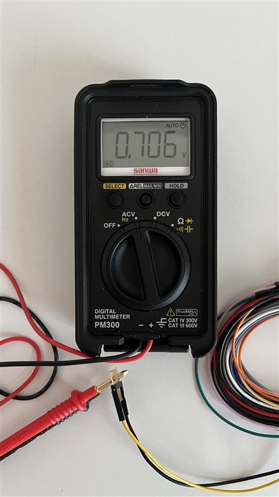

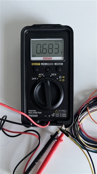

The last test was for ACV and frequency. For that purpose, I have used the waveform generator built in the Analog Discovery 3. Below there are results:
{gallery}ACV and frequency test
Measurement of sinus 1 kHz 1 Vpp
Measurement of sinus 100 kHz 1 Vpp
Measurement of sinus 50 kHz 1 Vpp
Measurement of sinus 50 Hz 5V pp

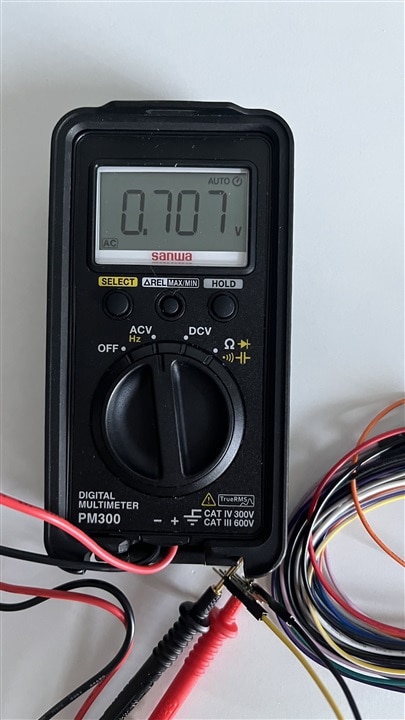

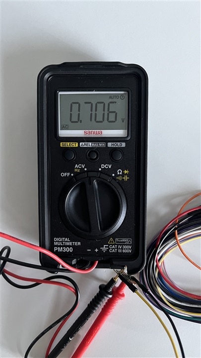

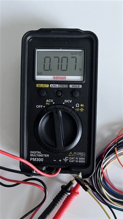

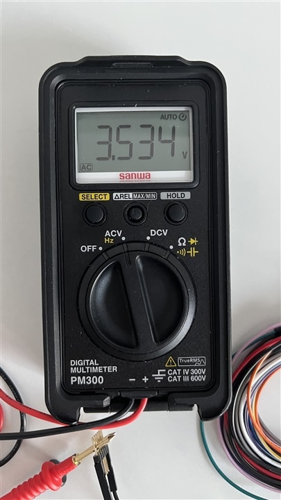

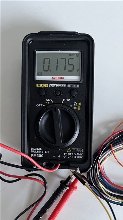

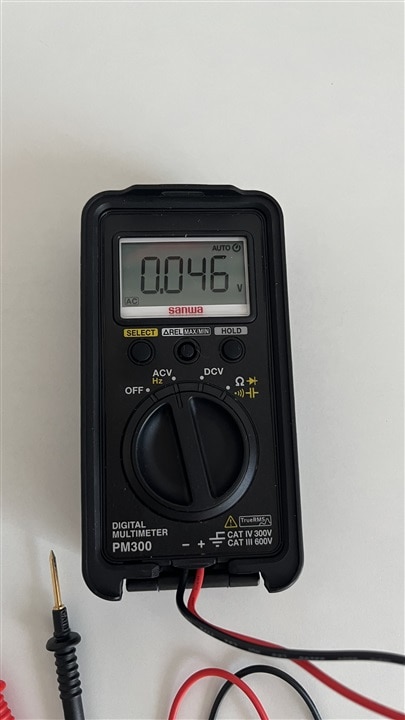

Here is check how ACV measurements behave in the case of a frequency change of 1 Vpp sinus signal from 50 Hz to 5 kHz. Below are the results:
{gallery}ACV test
Measurement of sinus 50 Hz 1 Vpp
Measurement of sinus 100 Hz 1 Vpp
Measurement of sinus 200 Hz 1 Vpp
Measurement of sinus 500 Hz 1 Vpp
Measurement of sinus 2 kHz 1 Vpp
Measurement of sinus 5 kHz 1 Vpp
