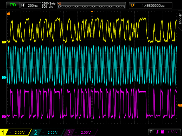

    I don't normally deal with high speed buses, but just for kicks, I decided to make the following experiment: I wanted a data line that is bad enough to easily fail, so I put a simple resistor on a breadboard (yeah, that's all it takes) and considered that my receiver is an FPGA. The goal was to reliably detect what is the best data rate I can push through that bus.
    To actually test such a bus, we can either use a logic analyzer or a device that works in the same parameters as our intended receiver, that can compare the locally generated PRBS with the received one. Since I put this experiment together on my bench, I simply used the same signal, but sampled from two different points in the circuit: before passing it through the part that distorts it and after, basically giving me two signals, a clean one and a distorted one.
    As the test device, I used an FPGA and in order not to deal with clock regeneration, I used the second channel of the 33622A as the clock, this allowed me to have the signal and the clock perfectly synchronized (check the notes). Alternatively, if clock regeneration is already implemented, the second channel can be used to source an identical signal to be fed directly to the test device.
    The only thing the FPGA had to do was to compare the clean and the distorted signals, on each clock edge and, if there was a difference, to power on an LED. I did not make a video of me turning the knob, but for what it's worth, the error LED turned on at around 60 Mbps.
PRBS @ 60 Mbps into breadboard bus
Ch 1: Distorted signal. Ch 2: Clock. Ch 3: Clean signal.

    jadew over 12 years ago in reply to DAB +1
    Hi DAB, I'm glad you asked. In the case of the low data rate signal, the distortion came from the optocoupler alone. There was nothing else in there that could affect the signal that much, considering…
  • jadew
    Hi DAB,
    I'm glad you asked.
    In the case of the low data rate signal, the distortion came from the optocoupler alone. There was nothing else in there that could affect the signal that much, considering the data rate. The reason why it was still generating full edges with the square wave signal, is because it was not getting fully turned on or off, while with PRBS it had the chance to do just that, which is when the latency of either the LED, the phototransistor or both came into play and became visible on the output.
    For clarification, in the second experiment (high data rate), I did not use an optocoupler, but a simple 330 Ohm resistor on a breadboard. The distortion there came, in part, from the resistor and the parasitic capacitance of the breadboard, which basically created a low pass filter and it's responsible for the attenuation and the incomplete swing of the signal. For the high frequency noise (the one that matches the clock signal), I blame the cable I used for the clock signal and the long jumper wires, but please note that it's the same frequency as the clock, so the same frequency with the highest frequency generated by that bit rate.
    While both signals can be recovered, I think the first one (the low data rate one) would pose more of a problem because of the very short pulses. The second one could definitely be recovered with just a bit of gain.
