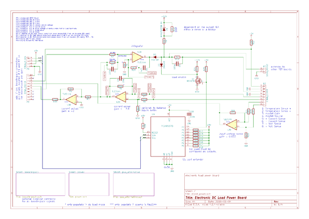

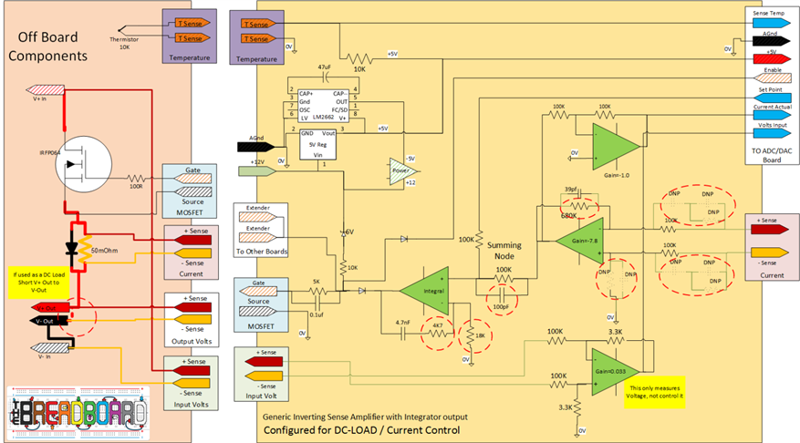

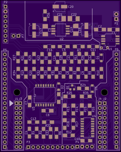

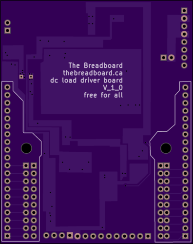

This post documents the main design for the the electronic load we made here on element14. The board that controls the load, measures performance and provides feedback.
Load Board
CAD version:
optional use as a PSU
PCB
BOM:
RefValueFootprintoptionalloadpsumanf. Nrsourcedescriptionurl

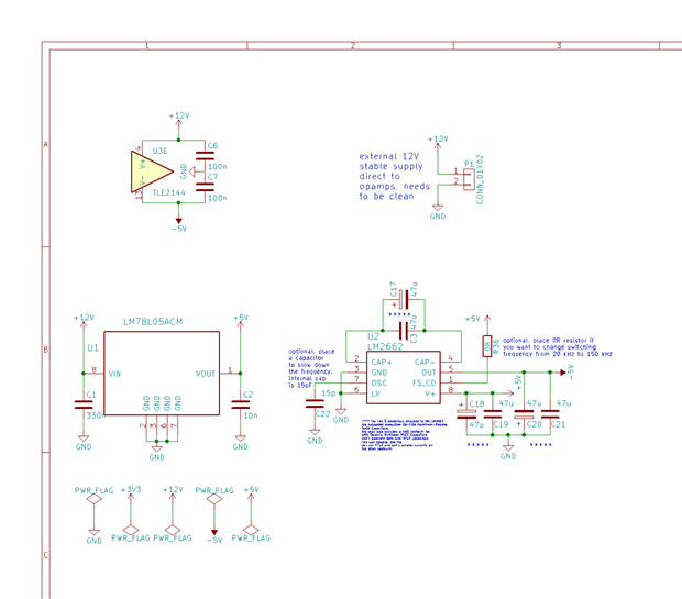

U1LM78L05ACMLM78L05ACMHousings_SOIC:SO-8_5.3x6.2mm_Pitch1.27mmxxLM78L05ACMLM78L05ACMelement14LM78L05ACMLM78L05ACMLinear Voltage Regulator 7805 Fixed Positive 6.7V To 35V In 5V And 0.1A Out SOIC-8 http://be.farnell.com/texas-instruments/lm78l05acm/ic-v-reg-5-0v-smd-78l05-soic8/dp/9489436
U2LM2662Housings_SOIC:SO-8_5.3x6.2mm_Pitch1.27mmxxLM2662MLM2662Melement14LM2662MLM2662MDC/DC Adjustable Charge Pump Voltage Converter 1.5V to 5.5V in-5.5V to-1.5V/200 mA out SOIC-8 http://be.farnell.com/texas-instruments/lm2662m/volt-converter-smd-2662-soic8/dp/9306803
