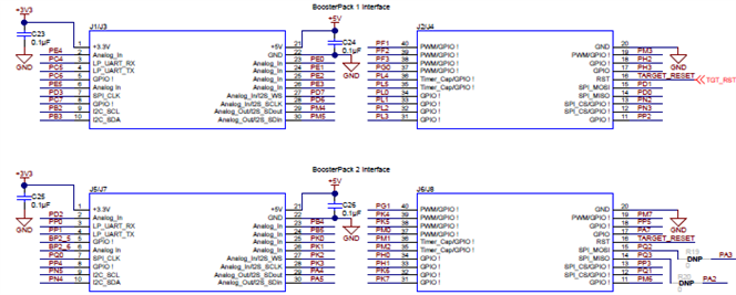

This blog documents focuses on the BoosterPack pins use for the electronic load that Robert Peter Oakes, jc2048 and Jan Cumps designed.
MSP432 LaunchPad pin assignments
PinNameUse
J1.1+3V33v3 for the i2c pull-ups
J5.3P3.2UART6 RX
J5.4P3.3UART5 TX
J1.9P6.5i2c SCL
J1.10P6.4i2c SDA
J3.22GNDground
J1.2P6.0LCD Power Control
J1.5P4.13LCD SPI CS
J1.6P1.5LCD SPI CLK
J2.2P2.5LCD External COM Inversion (not used)
J2.6P1.6LCD SPI SIMO
J3.29 reservedP5.4ADC_INPUT_A1 (not used)
J3.30 reservedP5.5ADC_INPUT_A0 (not used)
J4.39 reservedP2.6Board_PWM0 (not used)
J4.38 reservedP2.4Board_PWM1 (not used)
need to add SPI1 reserved
need to add SPI2 reserved
need to add SPI3 reserved
need to add SPI4 reserved
We can ignore the reserved pins. They aren't used. I'd like to avoid that we do use them unless we understand what flex we give up though.

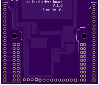

The PCB should have a white triangular mark next to J1.1 if possible. It's the indicator for the mounting direction (because the connectors are symmetrical, it's easy to mount the wrong way around).

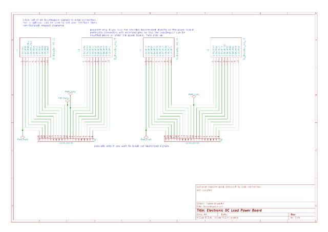

On the analog board, optional BoosterPack breakout edge connectors are available to add user interface elements.
These aren't isolated from the LaunchPad.
