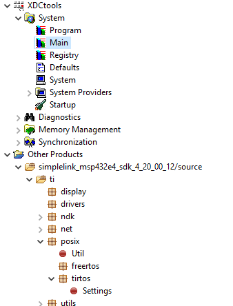

This blog documents focuses on the RTOS approach for the electronic load that Robert Peter Oakes, jc2048 and Jan Cumps designed.
  • CCS 8 with MSP432 compiler TI v 16.12.0.STS or >
  • TI-RTOS for MSP43X, any SimpleLink version
