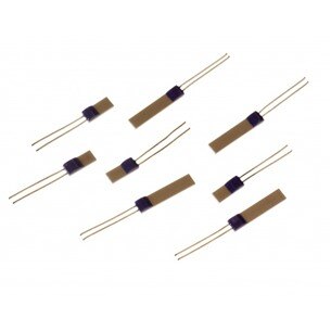

Flat Film Resistors
Flat film Pt resistors take the form of a thin (1 micron) film of platinum on a ceramic substrate. The film is laser trimmed to have a precise Ro value and then encapsulated in glass for protection.
A wide range of styles and dimensions are produced to allow for different applications. Such sensors have fast thermal response and their small thermal mass minimises intrusion in the media being tested. Such sensors are known variously as flat film, thin film or chip sensors.
