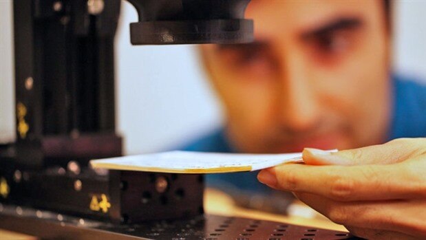

MIT researchers discovered how to read through a stack of papers using a terahertz camera and computational imaging. Their current results are promising and could have huge implications for historians, librarians, and maybe even secret agents. Barmak Heshmat, research scientist at the MIT Media Lab, reads through a closed book. (via Barmak Heshmat)
