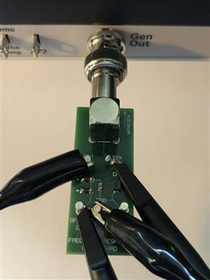

Frequency Response Analysis
A really useful feature and one that fits in with what an oscilloscope is often used for is the frequency response analysis function (FRA). The FRA leverages the analog measurement from the scope as well as signal output from the built in WaveGen. By connecting channel 1 to the input of the device under test (DUT) and channel 2 to the output, the system response can be measured. While this may produce a rough measurement, for an entry level piece of equipment the measurements are acceptable and helpful. This allows those wanting to characterize parts of a circuit or a whole circuit to do so without needing extra equipment.
The settings allow for a wide range circuits to be tested. The available frequency range is 20Hz ~ 20MHz, and the start and stop frequency can be selected anywhere within that range. Lacking is any information on what step sizes are used or how many sample points are used for this analysis. The peak to peak voltage can also be set between 1 mVpp ~ 9 Vpp ensuring no clipping or damage occurs to the DUT.
FRA measurement results with a bandpass filter from Keysight
Keysight Bandpass filter board for FRA testing
