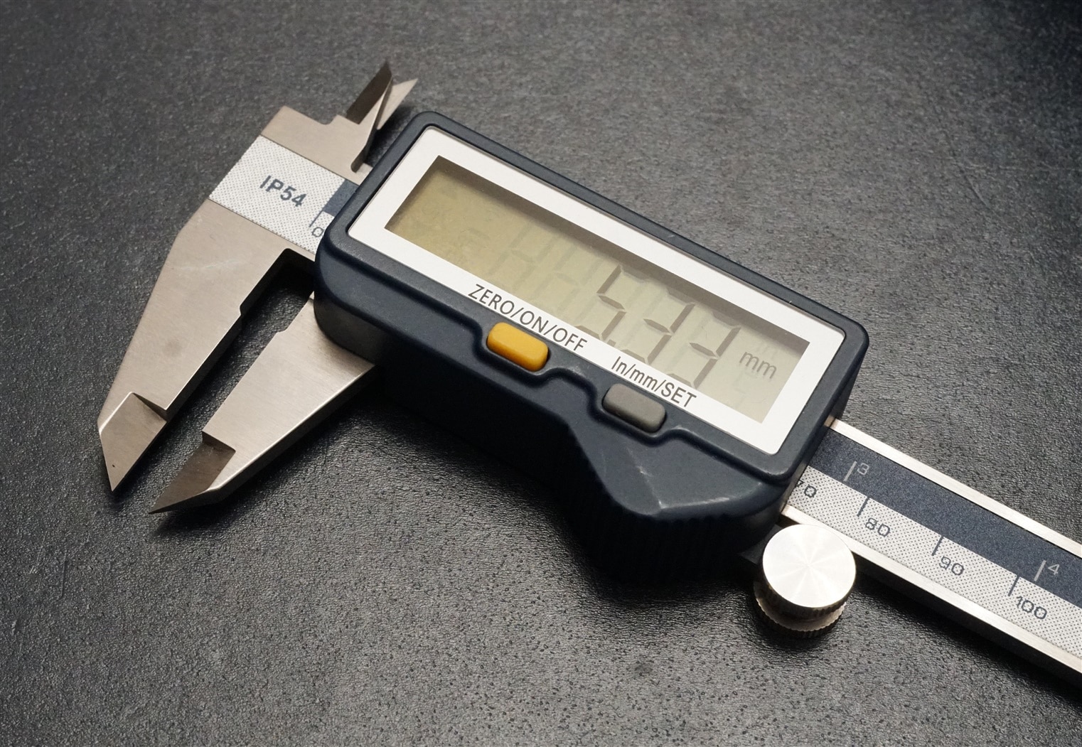

Look and Feel
The calipers arrived in a sturdy, purpose-built plastic case. While the case is excellent quality, I rarely use it since the calipers are in near-daily use.
In my experience, the calipers are as well-built as the Moore & Wright models I previously owned. The metal components slide smoothly, are well-machined, and feature a brushed finish. The plastic and front scale have a matte surface. The instrument feels great in the hand, and nothing has become loose over the year I’ve used the calipers.

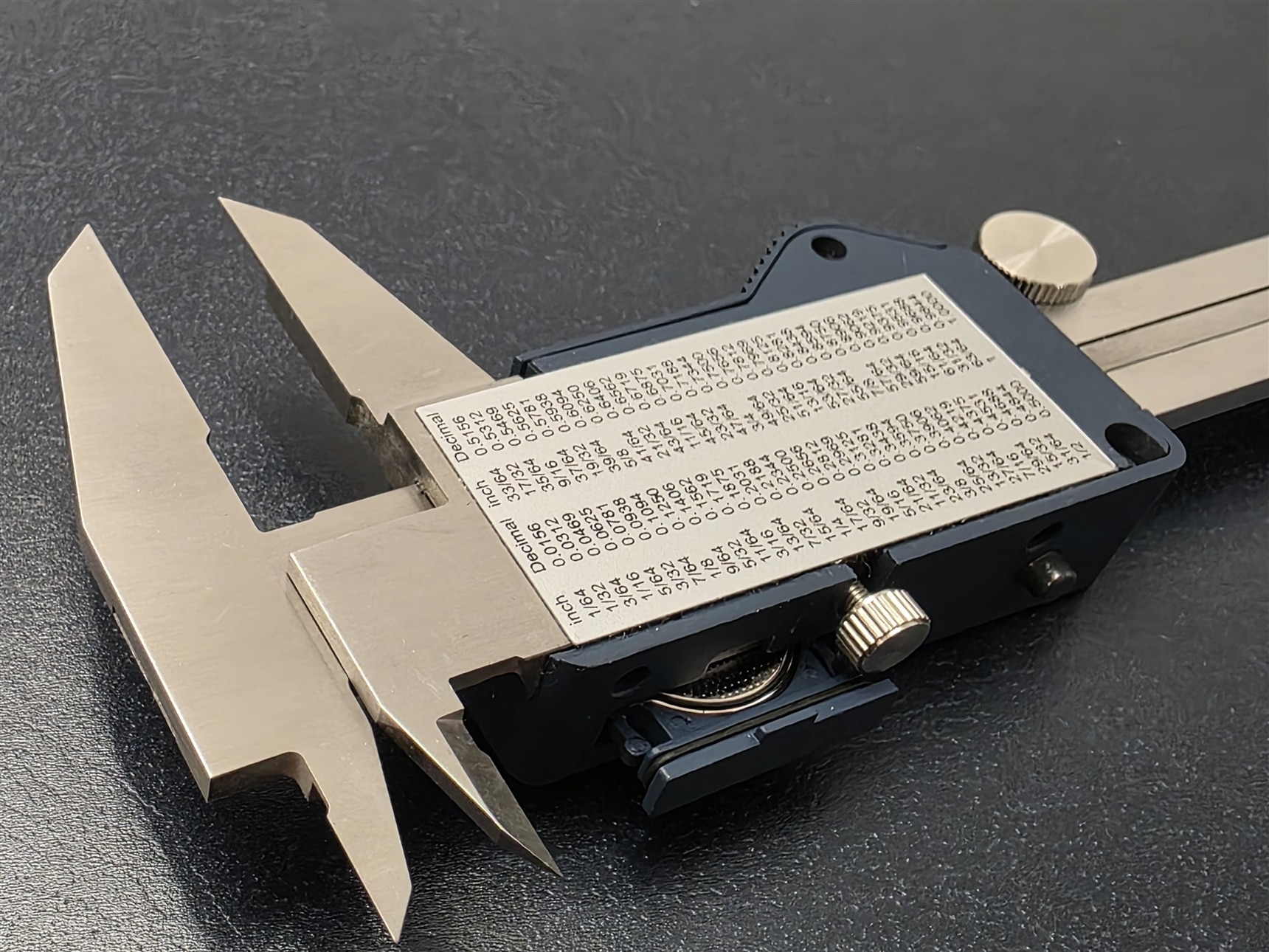

Overall, the 5101L is heftier than my old calipers. The electronics housing is substantial and made from thick, high-quality plastic. The battery door is secure and unlikely to get lost, as it slides in like a drawer and has a rubber seal. The locking screw has ample rotational travel before it could fall out.
On the rear of the plastic body is a table with fraction-to-decimal conversions. I haven’t needed it, and while the text is quite small, it’s still readable thanks to clear black print on a thick metallic label that covers as much of the underside as possible. The label isn’t recessed but has remained intact after a year of use.
The ergonomics are excellent - even when wearing gloves, the calipers are comfortable to operate. The buttons are clicky, with a spongy travel before the click is felt and heard. Personally, I preferred the softer press of the Moore & Wright calipers, but that’s just a matter of preference.

The device has its pros and cons. The LCD refreshes at four times per second, which is reasonably fast, though a speed closer to 8 Hz would be ideal.
The digits are legible, but slightly thicker segments and squatter characters would enhance readability. Display contrast is acceptable and perfectly usable, though not exceptional.

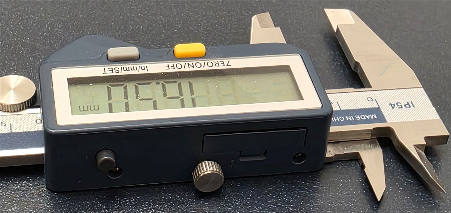

When powered on, the instrument always reads zero, regardless of the caliper’s actual position. Initially, this was frustrating, as I had to move the calipers to true zero and press the power button again to set the display correctly. However, I soon learned to power on the device only when fully closed, ensuring the displayed zero is accurate from the start.
One user interface quirk is the somewhat cumbersome power-off process. You must hold the power button for a few seconds to cycle through menu items, then quickly press it again when ‘OFF’ appears. I can see why they did this; the design likely assumes most users will rely on auto power-off, especially since battery life is excellent - I haven’t replaced the original battery in a year. Still, as someone who prefers powering off manually, I find this extra step mildly inconvenient.
