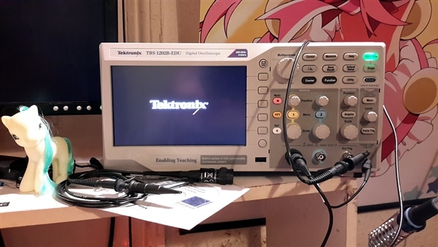

The oscilloscope arrived in a well packaged condition along with safety instructions, list of contents, CD containing documentation, 2 x 200MHz probes with accessories, a kind reminder and instructions on updating the firmware and finally a certificate of traceable calibration.

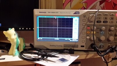

The TBS1202B is a very smart looking, compact piece of kit. The controls are very tactile with nice silky touch rubberised buttons and plenty of dials for me to twiddle till my hearts content!! (ps. some of them even press in, total touchy feely bonus!).
A really nice touch is the colour coding linking the input connectors to their specific vertical controls. All of the controls are nicely grouped together based on their function which really does help to quickly find the button or dial you need.

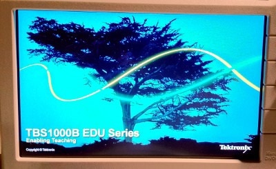

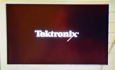

A final word (last but by no means least significant) on the physical features of the TBS1202B-EDU is the screen! I know I'm used to using a smallish analogue scope but I have had the experience of using digital scopes from time to time and never have I seen a screen so big on an oscilloscope. Plugging it in and pressing the 'on' button, I expected it to be a relatively low quality display but to my surprise the resolution and colour depth on the pictures as it was booting up were far above and beyond anything I would have expected.

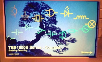

After doing some quick probing and getting used to the basic controls I had a quick look through the course ware system that's included with the '-EDU' range of oscilloscopes which has some basic examples and looks to be a very promising feature (not only to be used for course ware but it also strikes me as being a possible reference archive to keep on your scope, rather than writing up lessons, you could store some basic circuits, write out some popular data sheets and possibly even add some references such as resistor colour code look up guides and value conversion sheets. I know it's designed to store lessons for use in educational settings but it is definitely a feature that can be exploited to increase the usefulness of the oscilloscope on your workbench *1)
[*1 mini project for a quiet day]> copy a commonly used data sheet into the course ware system to test proof of concept.

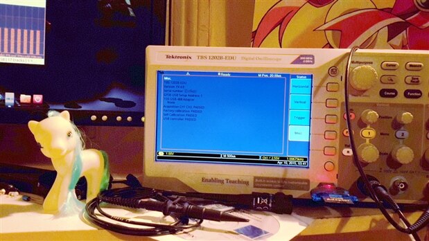

I'd put off the firmware update for long enough, so I followed the instructions that were included in the box and headed over to Tektronix website to download the latest update, all seemed to go well but no matter what I tried I was unable to get the update to be recognised and install.
I went back to the website and downloaded an earlier update thinking they might need to be installed recursively, indeed the earlier update installed without a hitch and I downloaded and started reading the user guide from the website (rather than from the CD) while I was waiting for it to complete.
Once done, I retried the latest update; once again, it wasn't being recognised as an update so I went back to Tektronix website to see if there had been others with the same problem, it seems that people originally had trouble installing the previous update when it was released and it was resolved by changing the file name. This was solved eventually in general by Tektronix changing the name of the update file on the website.
The latest update is a file called 'TBS1KB_3.TEK'. It seems that you have to remove _3 from the file name for it to be recognised as an update file by the oscilloscope so it becomes 'TBS1KB.TEK'. Sure enough! changing the file name does the trick and this update installs just as easily as the previous one.
