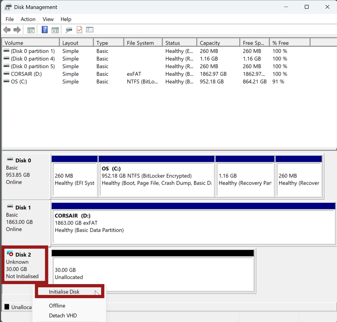

The disk drives will appear (usually that’s just the C: drive unless you’ve attached more). The aim is to create another one, a virtual disk.

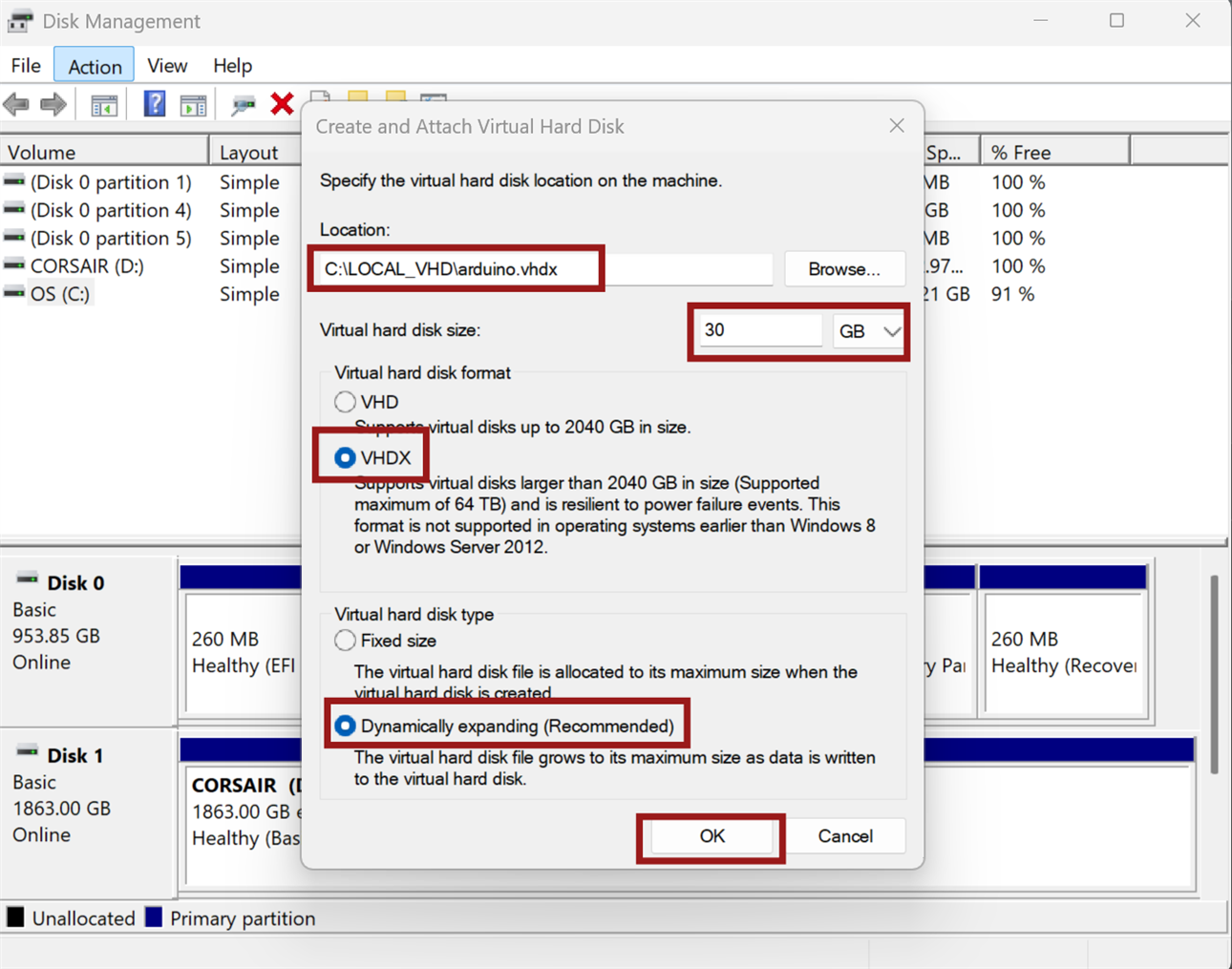

Select one of the drives (I selected the C: drive) and then from the top menu bar go to Action->Create VHD. Fill in the details as shown in the screenshot. Note that the 30 GB selected is not a real value; it’s a worst-case figure that should never be reached, because the virtual disk will dynamically expand when needed, toward that maximum worst-case value. For the example below, it’s best to set a large value, like 100 GB, if you’re not sure how many Arduino frameworks/libraries will be installed.
You’ll note that now the new disk appears in the window. To the left of it, the text shows that it’s not online, the VHD is not initialised yet. Right-click on that text and select Initialise Disk.
The new disk will now be online!

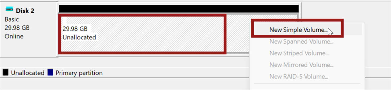

Back in Disk Management, right-click in the unallocated space, and select New Simple Volume.
Then, browse to the newly created folder, because that’s the folder that you want to become the mount point for the virtual disk:

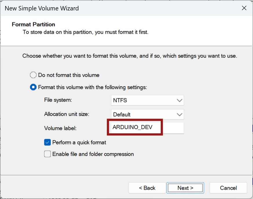

Create a suitable volume label, just for cosmetic purposes:

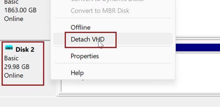

To unmount the VHD, in Disk Management, right-click on the virtual disk, and select Detach VHD.
(Note that if you wish to permanently delete the VHD, then don't first detach, but rather first right-click inside the volume, and select Delete Volume, and then do the Detach VHD. Then you can delete the .vhdx file from Windows Explorer).
To re-mount the detached VHD, in the Disk Management top menu bar, select Action->Attach VHD, select the .vhdx file, and it will be re-mounted back to where it previously was.

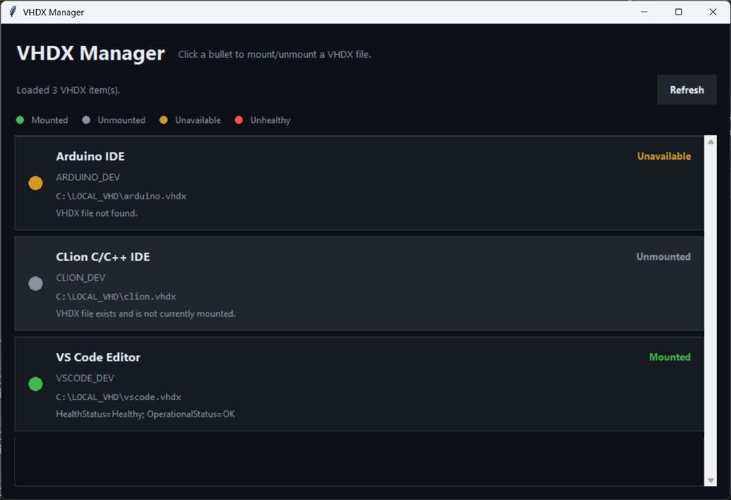

    shabaz 8 months ago
    I wanted a simple graphical way to manage all the VHDs.. this app took 27 minutes to create and debug using AI! It seems to function. I will tweak it a bit further and then place it on GitHub.
    Clicking on the bullets will toggle between mounted and unmounted states (saves me having to launch Disk Management, or to remember the PowerShell commands..).
