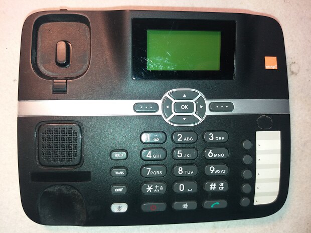

    Jan Cumps over 7 years ago
    I've purchased this from a garage sale (5€) with as only reason to scavenge some components and use the PCB to train my solder rework skills.
    The display's flex connector is soldered onto the main PCB. I will not be able to recover that.
