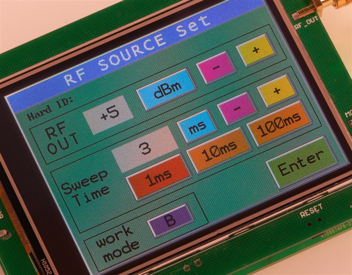

1. From the menu, frequencies can be entered in steps of 10 kHz, however, beyond some point past a GHz (I didn’t try to narrow it down) only 20 kHz steps are supported, even though the user can still enter values with 10 kHz steps. For those keen to use the board as a frequency synthesizer for radio communication, the 10 kHz minimum granularity could be an issue (it depends on whether the demodulation method will be analog, or software-defined).
2. The sweep function (see the photo below to see how part of the configuration is set) isn’t as useful as it could have been. It only works in steps of 1 MHz, even though the user can enter values with 10 kHz granularity. It’s also buggy, for instance, the start and stop frequencies are never reached, just the in-between values, and sometimes I needed to restart the unit when reconfiguring the settings. If 1 MHz or higher sweep steps are acceptable, then the MAX2870 is quite fast at switching frequencies. It was possible to step across large frequency ranges (hundreds of MHz) with steps of just a few milliseconds.
3. The output could have been much better. The design uses a single-ended output. It would have improved the signal quality if there had been a transformer on the differential output.

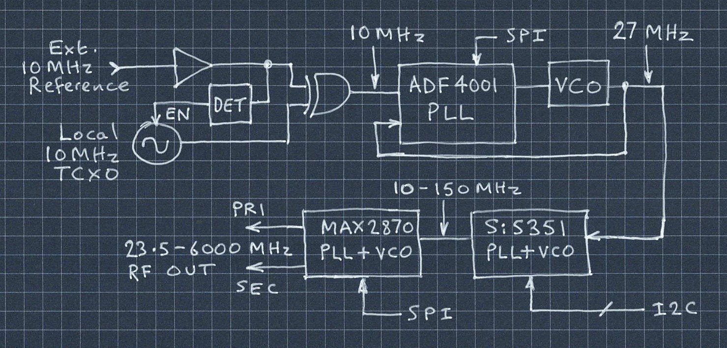

    The proposed block diag.. it grew to three PLLs! This is the flow:
    * On-board 10 MHz oscillator module, plus the capability to attach an external reference
    * First PLL is used to generate a 27 MHz clock.
    * Second PLL is a Si5351 combined PLL+VCO which can be configured with decent granularity to anything up to around 150.000MHz. This PLL is optional, it can be omitted and bypassed if desired.
    * The output from the Si5351 (or the 27 MHz clock if the Si5351 is bypassed) clocks the MAX2870. The advantage of the Si5351 stage is that since it can be adjusted, that means we can achieve extremely high granularity (in the order of Hz or less).
    Although the design is now three times the size! I think it's worth it, since it allows very high granularity, suitable for any radio application, plus it can be locked to an external reference.

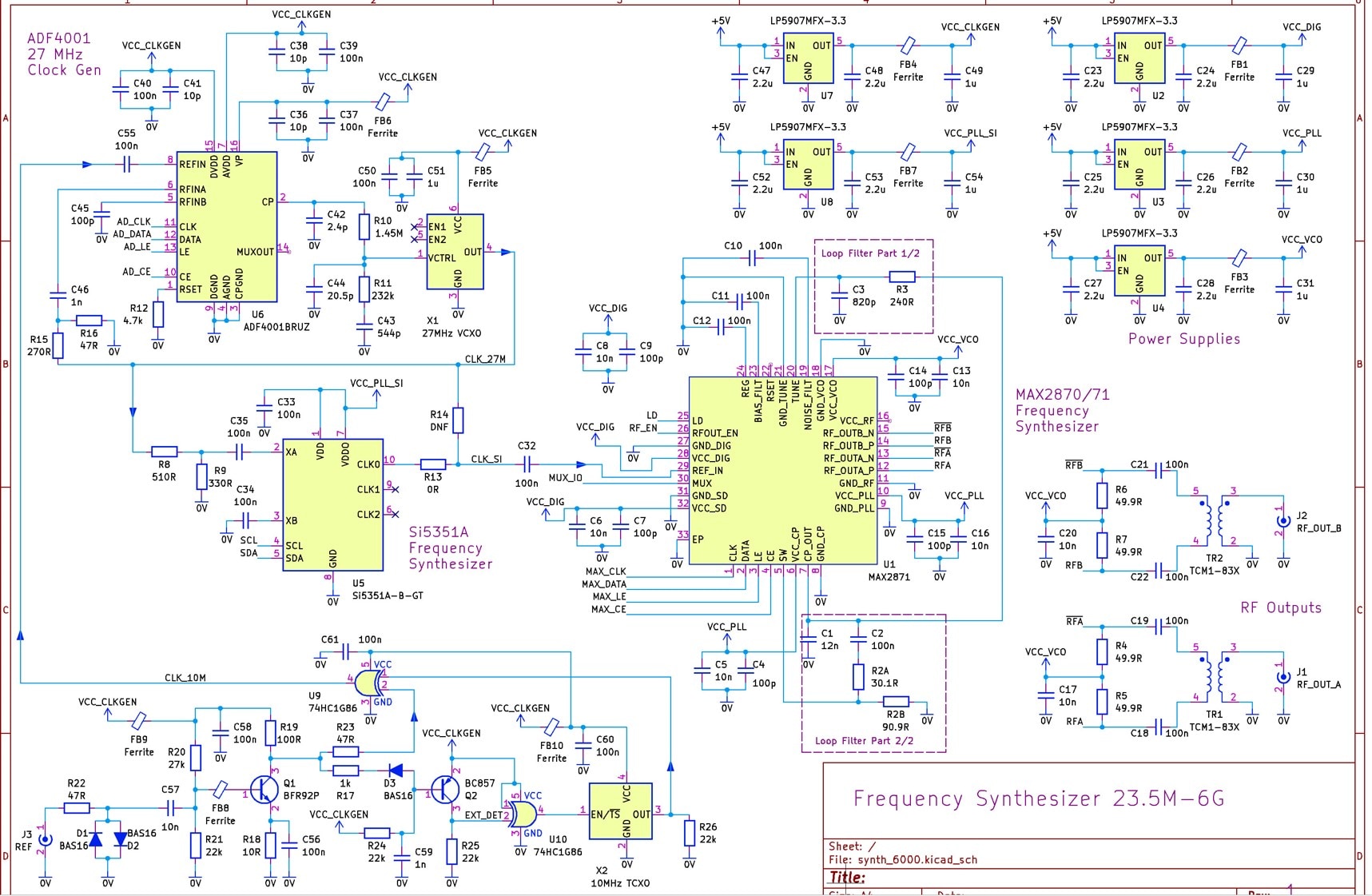

    Regarding the PLL loop filter for the ADF4001, I wasn't looking forward to trying to figure it out, but I used the ADIsimPLL software, it is very neat, it generates the circuit plus provides lots of useful info. Really impressed. This was its output:
    Putting it all together, here's the circuit. Very cramped! I might have to move to additional sheets, but I wanted to keep it to a single page if possible.
    I think everything is there, apart from the connector to be able to attach to a microcontroller. Anyway, I'll leave it in this state for a week or so, in case there are any errors or suggestions.
