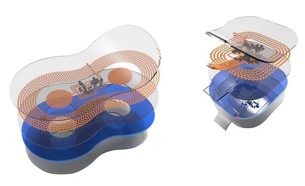

The dual sensors: Chest sensor (left) and foot sensor (right) are very lightweight. (Image Credit: Northwestern University)
The new technology measures more than what's found in traditional monitoring systems. Dual wireless sensors monitor the babies' vital signs, all of which includes their heart rate, respiration rate and body temperature, all from both ends of the baby. One sensor is placed across the baby's chest or back, measured at 5 centimetres by 2.5 centimetres, and the other goes around the foot, measured at 2.5 centimetres by 2 centimetres. The placement and size of the sensors allow physicians to collect the core and body temperature from a peripheral region of an infant. Measuring the temperatures between the foot and chest have a high amount of importance when determining blood flow and heart function, which isn't measured these days. image

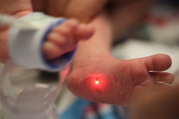

Foot sensor as shown in the image makes it safer than traditional monitoring systems. (Image Credit: Northwestern University)
Physicians will also be able to measure blood pressure levels by tracking when the pulse leaves the heart and arrives in the foot. There doesn't seem to be a safe and healthy way to collect and measure a baby's blood pressure especially when a cuff can cause bruising on a newborn's skin. An alternative to this is to use a catheter by inserting it into an artery. However, this also isn't safe because of the small size of blood vessels found in the newborn baby. It also increases the risk of infection, clotting and death. Sticky tape that is also used to attached wires to the body can also cause damage through irritation, blisters and infection.
