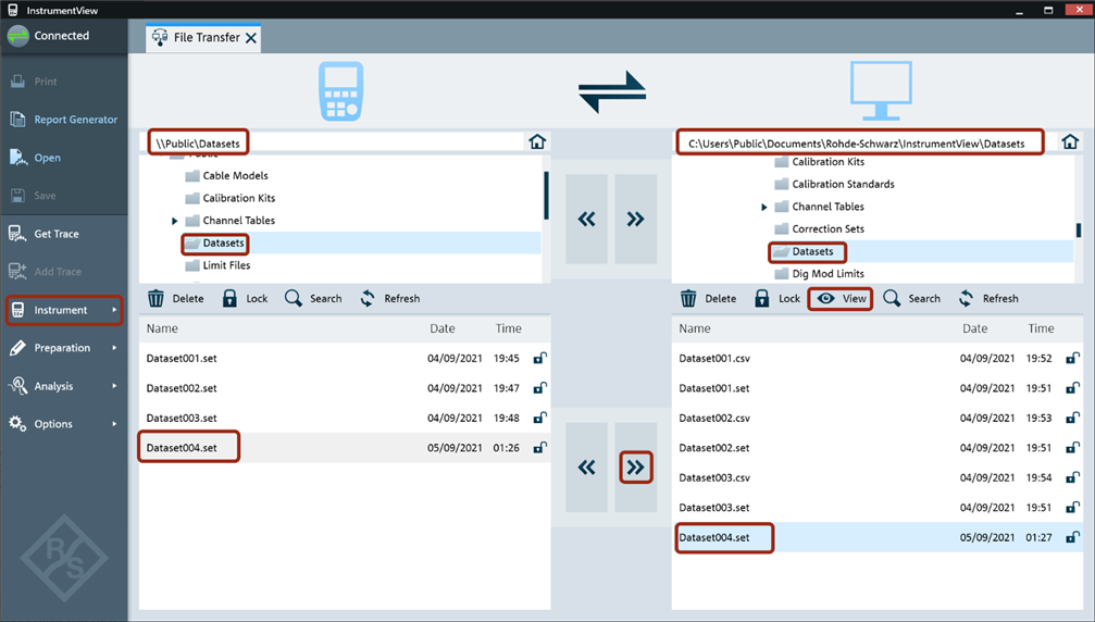

2. Transfer the Data to the PC
Start up InstrumentView and select Instrument->File Transfer. Transfer across the Dataset00x.set file as shown in the screenshot.
Then, with the dataset selected on the right portion of the display, click on the 'eye' icon labeled View (see screenshot).

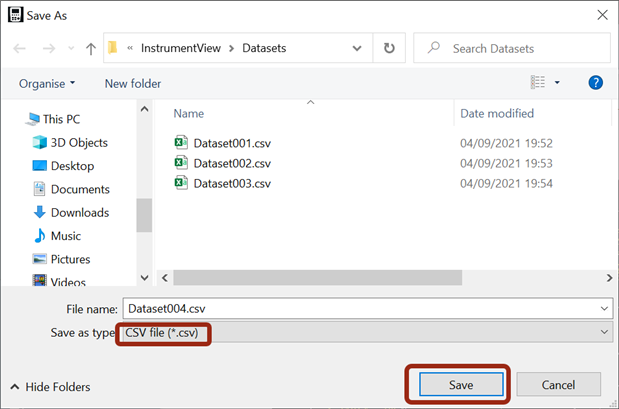

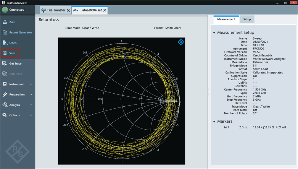

3. Export the Data in CSV Format
After clicking on the View icon in the previous step, you should now see the data displayed graphically.
Click on Save on the left side, as shown above. Save the file in CSV format, to any suitable location.

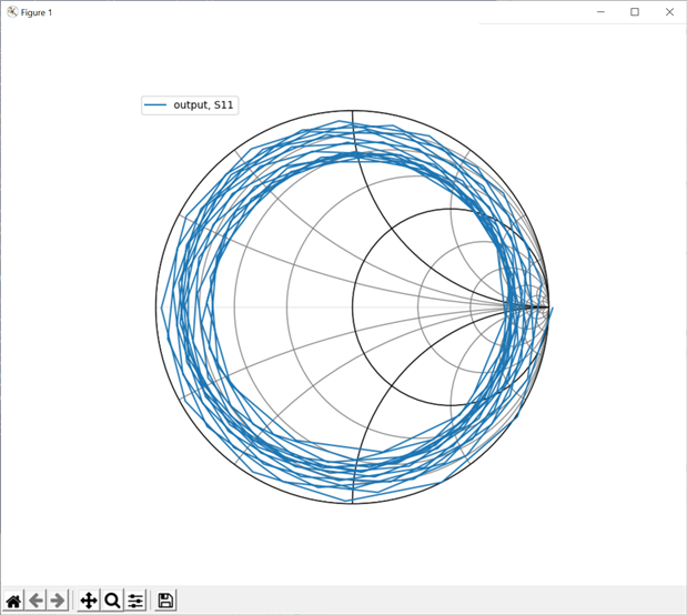

Example: Viewing using Python scikit-rf
The output.s1p Touchstone file was generated in the last step.
To view it, install matplotlib and scikit-rf Python packages to your PC, and then you can type the following within the Python command line, or in a .py program:
import matplotlib.pyplot as plt
import skrf as rf
n=rf.Network('output.s1p')
n.plot_s_smith()
plt.show()
If all goes well, the following should be displayed:
