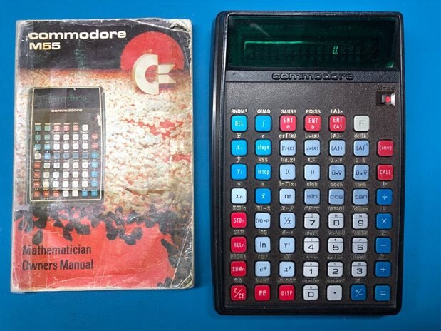

    I have this:
    It's still functional but it does occasionally throw a wobbly - I was going to take a look and see if it's anything obvious.  What's not very surprising is that it is slow.  5! takes an absolute age to calculate.

    clem57 over 6 years ago in reply to Andrew J
    Gough Lui did a good write up on calculator reworking back to lif. Maybe he can point you to some things to try.
    Clem
  • Andrew J
    Andrew J over 6 years ago in reply to clem57
    Thanks Clem - that's a good pointer.
  • Gough Lui
    Gough Lui over 6 years ago in reply to clem57
    Never took a look at a CBM device myself - but depending on what it does or doesn't, it could be a bunch of issues.
    Things to watch out for include:
    - Dirty battery contacts and weak springs causing poor battery contact, or intermittent power switch contact.
    - Problems with keyboard contacts causing keys that are not consistently responding. Sometimes repeatedly retrying the key clears the oxidation.
    - Loss of a keypad row/column - flexible connection ribbons tend to go bad on these devices and develop cracks - careful soldering or bridging with wire can help.
    - Display issues - sometimes due to problems with non-working boost converters.
    - Computation errors - sometimes chips do go bad or the power isn't as clean as it should be. Changing capacitors may help sometimes.
    - Completely "dead" - check for shorted tantalum capacitors, bad diodes, problematic DC-DC converters.
    Best of luck with troubleshooting - some of these older devices are surprisingly reliable and resilient!
    - Gough
  • Andrew J
    Andrew J over 6 years ago in reply to Gough Lui
    Thanks Gough.  The best way to describe it would be a need to let it warm up first.  But sometimes it goes flakey after being on a while so that’s not really it.  It stops responding to input: recognises a key press but just displays ‘error’ on the display.  My thoughts were dodgy keyboard connector/contacts; bad caps; failing IC.
  • Gough Lui
    Gough Lui over 6 years ago in reply to Andrew J
    Hmm. Warming up - I suppose it depends on how long. Some of those VFD displays do take a short while (a few seconds) to come to full brightness as the internal heaters come up to temperature. But this also depends on the design of the heater supply circuit (assuming there is one). Other times, as VFDs grow older, they tend to dim as the phosphor wears out or the vacuum inside starts to leak.
    As for the odd behaviour - perhaps there is a keyboard issue but one that's less obvious. Perhaps there might be a key somewhere that gets stuck as it warms up causes keyboard "ghosting", intermittent keyboard connection, problems with a voltage supply, phantom input perhaps due to electrical noise (e.g. if the calculator thinks a divide-by-zero happened, you would get an error too). Hard to troubleshoot, but start with the physical inspection ... sometimes it's going to be a shot in the dark - other times made easier if you have a working companion to compare signals and readings against (or swap components).
    - Gough
  • Andrew J
    To be a little clearer.  It typically manifests itself when first turned on: when a key is pressed 'error' appears on the display.  Pressing the 'C' (clear) key, gets rid of it and zero is displayed; pressing a key results in 'error'.  This seems to last a little while and then stops and the calculator works, hence the 'warming up' statement.  However, occasionally it is working and then starts displaying 'error' again on a key press.  That happens much less frequently.  So I don't think it is warming up but something else.  After all this time, and given it happens on a keypress, I think the keyboard has something to do with it.  When I take it apart it may become more obvious but part of me is reluctant to mess with such an old device, I don't know why really!
