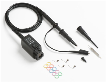

    As well as improvements in the box itself we also being making some head way with the probes. For years now most scopes on the market are supplied with high impedance, x10, passive probes with bandwidths up to 500MHz. These probes would typically have tip capacitance specifications of around 9-12pF. Customers have always felt a little cheated with they order their nice new 1GHz scope only to discover that it is effetely only 500MHz because of the limitation of the probes shipped with them. If you wanted higher bandwidth to match scope, or if you where using logic such as ECL which could be sensitive to capacitive loading, you'd have to fork our more money for an active probe. and to be honest active probes aren't cheap. They're in around $1000 each for a 1GHz probe. Along with introducing a new class of oscilloscope with the MDO series Tektronix also make a breakthrough the performance of passive probes with the introduction of the TPP series probes. These probes offer up to 1GHz bandwidth, <4pF tip capacitance and come as standard with all MDO3000, MDO4000 and MSO5000 scopes from Tektronix. Other features include automatic probe recognition and AC calibration with a custom ASIC.
    All of these features add up to ensure that the probe has a minimal effect on the signal under test, showing you what's truly going on in your circuit.
    For more information on how probing effects your device check out this short blog I have written.
    Regards
    J

    Hi John
    You are right.  There is no sense owning a good testing device if you are using less then stellar probes.
    Especially with oscilloscopes.  If there is a probe issue, then everything you can learn about a signal is skewed and probably in error.
    It goes with the theme where good tools yields good results.
