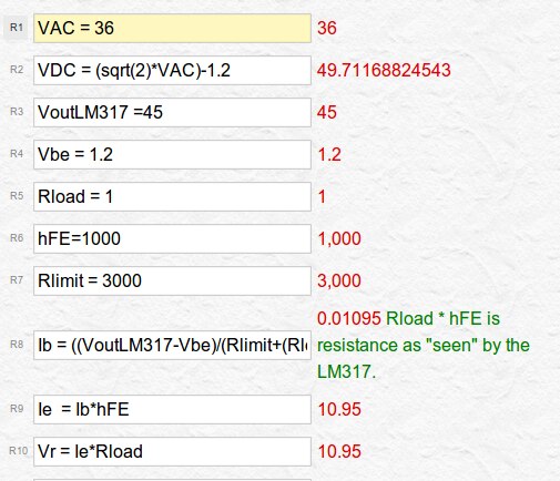

        I am currently working on a small circuit that controls the voltage to an electric dental lab handpiece. Please see the schematic below. This circuit has had a chronic problem with failure of the TIP-122 Darlington. The problem arises when the handpiece operator applies pressure which adds load to the motor and the motor then demands more current from the circuit. This circuit is very simple with basically no overload protection. The original design did not even have a flyback diode across the motor. My question is if it is practical to add another TIP-122 Darlington in parallel with the first one in order to improve current handling capacity. Does anyone have any experience with this type of modification? I also have a curiosity codicil to my question. If it is practical to add another Darlington, what would be the limiting factor to how many parallel Darlingtons can be added in this way? Any insights would be appreciated.

    Hi John, You say that the circuit has no short circuit protection, but the 3k resistor with a hFE of 1000 means some current limit: The supply is 36×√2 -(1.2V diode bridge drop) ≅ 50V. At startup the motor…

    Hi John,
    At startup the motor does not generate back-EMF, and the capacitor is empty, so you'll basically just have the 1 Ohm as load.
    I did a short calculation here (this will link to an editable version):
    The combination of the 1 Ohm resistor and the darlington base resistor limit the current to somewhere around 10.95A. Of course this will heat up the darlington, but it is a current limit. If you will meddle with this circuit, this behaviour will also change. As you can see, changing the output voltage of the LM317 will also change the current limit. If you parallel, double each darlington's base resistor to keep the current limit.
    Now for parallelling: this will only work nicely if the darlingtons' conductance has a negative temperature coefficient: if they heat up, they should conduct less. In that way the load will balance evenly over the darlingtons. If the temperature coefficient for conductance is positive, one of them will heat up, conducting better, so getting more amps and heating up more, etcetera.
    Succes!
    edit: added the Rload of 1 Ohm in the calculation of the current limit
    Victor
    jw0752 over 12 years ago in reply to vsluiter
    Hi Victor,
    Thank you for the well written analysis of the current limitations in my circuit. I am going to study it closely to help me learn from this situation. Your mention of the change in circuit characteristics when the Darlingtons have a positive or negative temperature coefficient reminds me of number series in mathematics and determining whether they converge or diverge. A positive coefficient will cause the two darlingtons to diverge triggered by small differences in their specs while a negative coefficient will keep them working together as either one that is taking more of the load will heat up and self regulate to a lower current level. One thing that has me concerned is that the rectified voltage 36V * 1.4 = 49.7V should be too high for the LM317. Is this possible because the adjust and output are not at 0V? I have already taken up too much of your time. It was good to hear from you again and thanks again for your insights.
