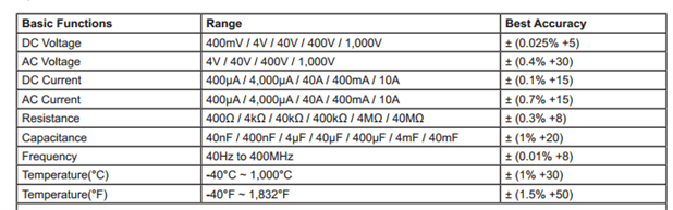

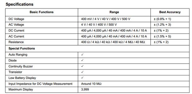

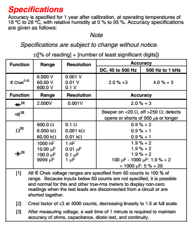

    Your testing has shown some of the fineprint in those 'cheap' meters.
    I think the heading was "Best Accuracy", but didn't say it was across the whole range
    Tenma basic
    Tenma advanced

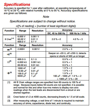

    Fluke Basic (113)
    So it seems that 2% is not gone and we aren't spoiled at all.

    Very well spotted. I always assumed "Best Accuracy" was a translation error on Uni-Trend's behalf. I suppose, instead, they might mean that's where the bottom of the "curved" error percentage slope is guaranteed to hit instead, in which case it's a fairly useless spec. It's like saying that my kitchen scales have a best error of 0gm!
    Alas, the Fluke 113 specs seem a little disappointing, but also, a lot more truthful. I suspect one must spend even more than that ...

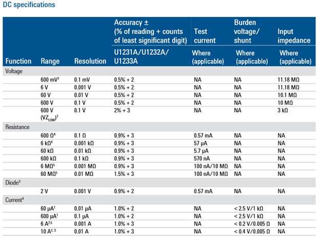

    At the basic end of Agilent Technologies/Keysight Technologies range is the U1231A, listed at AU$116 (http://au.element14.com/keysight-technologies/u1231a/multimeter-trms-6600-count-4-digit/dp/1903369):
    So, it looks like it's a 0.5% + 2 digits for the "basic" voltage. Surprising the difference in spec between the Fluke and this one - but it seems that's where the 3.5 digit meters "wanted to be" but weren't.

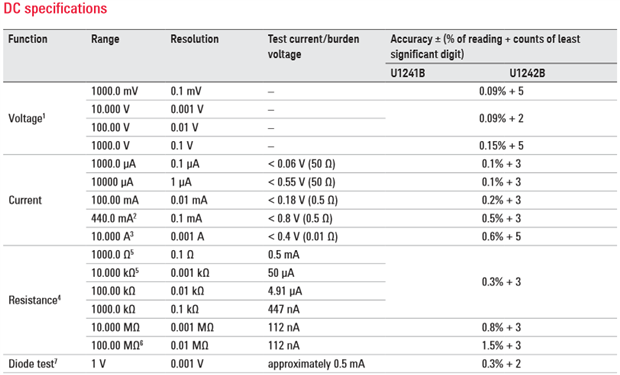

    Spending a little more, we might be able to improve the accuracy further - Agilent Technologies/Keysight Technologies U1241B, listed at AU$241 (http://au.element14.com/keysight-technologies/u1241b/multimeter-trms-10000-count-4-digit/dp/1780325):
    Considering that both units are 4-digit, this one says it's 0.09% + 5 digits. So while its percentage error is much less, the error number of digits in the least significant digit is higher.

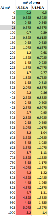

    How would this affect a range, I wondered ... so I did a quick Excel calculation using the 1000mV range as an example:
    It seems that ~75mV into the 1000mV scale, we are close to the break-even point where the increased error of 0.5% overtakes the +5 digits of uncertainty. So the more expensive meter is likely to show more errors for readings below ~75mV on the 1000mV scale (i.e. 0.75% scale deflection). I suppose this can be an issue if the ranges are strict and feature no overlap - so say measuring 1.002v on the 10v scale ...
    Still rather fascinating and head-scratch inducing specs image.
    I think the 113 is aimed as a electricians meter, and while accuracy is part of a meter's performance, its not he only one.
    Discrimination of DC v AC is another along with speed of obtaining the reading, especially continuity.
    Unfortunately unless you've had exposure to meters like these, some of the other performance items you might not have an idea of, or how they affect your use of the device.
