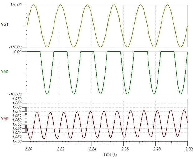

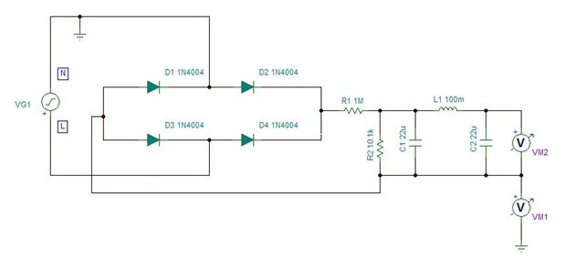

I built a circuit board to measure 120VAC using a Raspberry PI. I have a bridge rectifier and voltage divider. All using surface mount 1206 parts. Everything works well. When I put a voltmeter on the test point it shows 1/100th the line voltage in DC. However, when I actually look at it on a scope, I see that the ripple is 0 to 1.2v, essentially the full rectified voltage. The filter isn't doing hardly anything.
I'm trying to keep is all as small as possible so I'd like to stick with 1206 package for the filtering capacitors especially since the PCB has already been manufactured using these. I did use a through hole for the inductor it has 5mm lead spacing. Can someone recommend what capacitor and inductor values to use to get a cleaner DC(ish) voltage. The voltage divider is before the filtering so using low voltage capacitors are not a problem.
I was using 1000pF on C1 and 2200pF on C2 and 100mH for the Inductor. Below is the layout:
>-------- L1 ---------->
     C1        C2
Any help would be GREATLY appreciated...

    First I must give you the quick lecture on mains safety: USE AN ISOLATING TRANSFORMER !!! If your circuit is connected to the mains supply it is not safe. Now to filtering some safe 60Hz AC to measure…

    The best advice I have is DON'T.
    This is a potential death trap, and should NOT be undertaken.
    The circuit as presented is bad enough, but the pcb requires clearances to stop arcing if there is a power surge.
    As the others said use a transformer to drop the voltage down to 10v or less and then apply filtering and voltage dropping.

    If you are determined to use the circuit you posted, be sure to label the line and neutral carefully and make sure anyone who maintains it knows that they must be wired the correct way round. If you swap them, you'll still get the voltage reading, but the GND of the Raspberry PI will get to -170V relative to mains earth.
    I'm assuming here that the output of the PSU to the PI floats and that you live in a part of the world where the neutral is close to mains earth (which seems to be everywhere).
