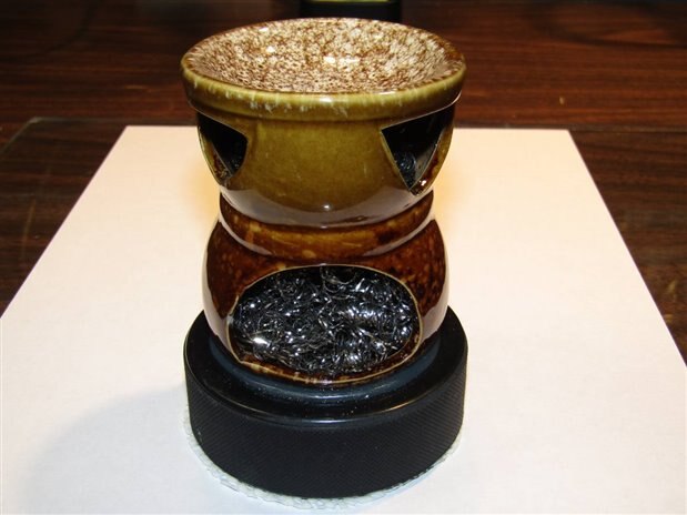

    Hi Mark, I actually cheated too and I also found this small ceramic thingy at the $ store. It is supposed to be used to heat aromatic oil like a scented candle but I retasked it. I have glued it to a hockey…

    This conversation sounds like a good reason for an experiment to determine which is ideal for proper soldering tip matainance, sponge or brass wool as method of cleaning solder tip.
    I currently use a cheap wet sponge pad but have found the brass wool to be very effective when used in the past.
    A wet sponge works great but the sudden temp changes do not seem like it would be beneficial to the lifespan of the tip, heating element, and any temp sensor the soldering iron might have.
    The concern with a brass tip cleaner might be some damage to the surface of the soldering tip with extended use.

    That experiment could take a long time to complete, it's the sort of thing I expect the big soldering station manufacturers may have done but it would be interesting to see this done or maybe try and collect data from a number of people over time and see if there are any trends in how the iron tips last vs how people look after their iron tips.
    In my experience I have had soldering iron tips have what appears to be an outer coating delaminate after extended use when using a wet sponge but I have never seen this on tips since using the brass cleaner. I'm particular about keeping my tips clean and re-tinning them after cleaning so they don't get any oxidisation and I do this regardless of the cleaning method. I don't have enough data to draw any concrete conclusions about tip life vs cleaning method as the tips I had issues with were from a different soldering station brand than I now use so maybe that's a factor in longevity too.

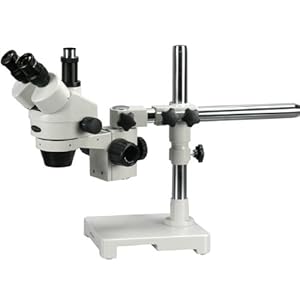

    I have an AmScope one (but without the branding - I shouldn't call it an AmScope microscope, but I'm pretty sure it's the same thing they're rebranding), with the boom stand, something like this: https://images-na.ssl-images-amazon.com/images/I/41N-I8m7DKL._SY300_.jpg
    There are other places out there that sell the same microscope. Initially I wanted to get them directly from AmScope but it gets expensive when you take shipping to Europe into account, so I had to find a different source.
    Wherever you get them from, make sure you look into the video capturing system. You have to be on the lookout for:
    1) Poor resolution.
    2) Video latency.
    3) Lack of parfocality between the eyepieces and the camera (meaning that when the image is in focus through the eyepiece, it wouldn't be in focus on the camera). This is a problem I'm facing, because I don't have the proper adapter for the camera I'm using (a canon DSLR).
    4) Optionally, you may want to look into a trinocular that doesn't have to turn off one eyepiece in order to direct light to the photo port, but those heads are more expensive.
    I also recommend getting the 0.5x Barlow lens, because it increases the working distance and increases the field of view at the lowest zoom setting (the magnification gets halved, but the resulting range seems perfect for electronics work). With the .5x Barlow you get almost 20 cm working distance, which means you can poke with a screw driver from an almost 90 degrees angle.
    I don't recommend the 20x eyepieces, they're useless, but I'd get the 2x Barlow lens, because you can then inspect very small things with it. I also recommend getting an UV filter that you can fit on top of the lens (you can find cheap ones on ebay - it's just glass), in order to protect it from smoke and splatter.

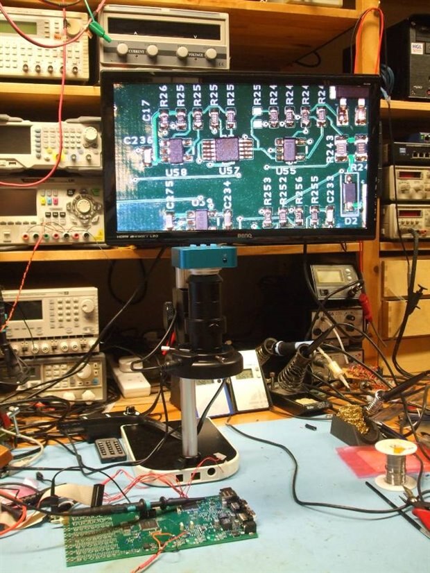

    I think michaelkellett system has dual outputs, HDMI and USB by the looks of it, so will have reduced lag.
    The USB-only options tend to have lag, because there isn't enough bandwidth available so it compresses first. USB 3.0 would solve this, but then the options may be fewer. I've used a GigE camera, that provides uncompressed video, but nevertheless there is a (very slight) lag, although I have used it for component placement or soldering while viewing on a PC. The lag can be tuned out partially, depending on how it is connected (directly or through a switch) and packet size configuration on the PC and switch.
    I've tried a few combinations, it is still sub-optimal, but in the end I use a couple of systems with one camera: microscope and camera for very close-up inspection, but mount the same camera with a different lens and stand for component placement.
    You're right - and I'm using the HDMI connected directly to a monitor. The speed is fine for soldering.
    I think it's important to actually try the system if you are going to spend a lot of money - my Ebay camera and lens was so cheap that I didn't bother and it works OK, if I hadn't had the demo I might have bought the Mantis and I would not have been  happy at all.

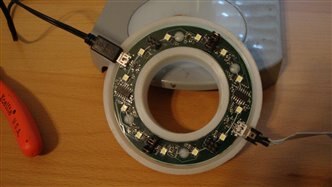

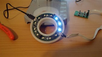

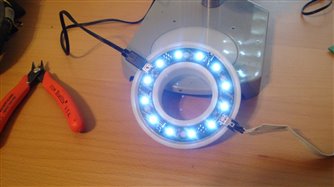

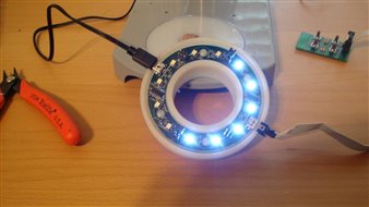

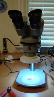

    0 genebren over 9 years ago in reply to rachaelp

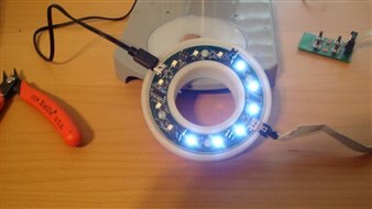

    Accessory wise the Barlow lens and the light ring make my Microscope very useful for solder.  When it came to the light ring I ended up building my own.  I wanted to work with a combination of full illumination and then various segments in order to make some defects really pop out.  With the design I came up with, each of the LEDs (12 total, with each LED package containing 3 individual LEDs) is uniquely controllable.
    I have modes to select the number of LEDs to turn on and then to rotate the pattern around the ring, one LED at a time.  There is also a couple of gradient patterns, where all the LEDs are on, but the intensities ramp across the filed.
    This was fun project.  I even machined the housing out of HDPE plastic.

    0 jw0752 over 8 years ago in reply to genebren
    Hi Gene,
    What a great innovation. The ability to use light from different angles has to make the scope a much more powerful tool.
