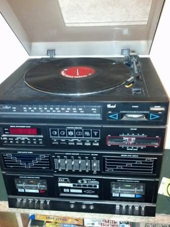

Hi, I have not done any of this since HS 25+ years ago, so I am a bit lost because the system is acting strange.
I have a cariole compact stereo system from the 70's recently it started having power issues. It did not always have power to the stereo part when I pushed the power button, yet the clock which is always on is still working. Now it rarely has power when pressing the power button. It has been dead for the last several months and today again I heard popping sounds coming from the speakers with the power button in the off position and found it again had power. I put on a record and played the first side, the middle of the second side the power died and its dead as a doorknob again save for the clock which is still on.
So I know it can't just be a fuse. It can't be a total power supply failure because the clock is still working. If it was a bad tube I would think it would be totally dead by now same with a bad large capacitor in the power supply. The power switch was on when it lost power, so I would assume its not the switch. The selector switch was functioning when it had power so I assume it was not that.
So where do I start in trying to diagnose this system to find out where the issue is to fix it as it works fine when it has power in the system,.

    In a system that old, you probably have some bad capacitors in the power train along with corroded contacts on switches and connectors. Time to get out a voltmeter and oscilloscope to start tracking the…

    Hi James, I am very suspicious of the switch itself. These switches do wear out and certainly over twenty five years the contacts will tarnish. Once they start to arc it is the beginning of the end as…
    jw0752 over 8 years ago in reply to napthyme +2 suggested
    Hi James, Sorry I can't guess more at this time. You will have to get out the tool box and crack it open and see what the situation is with the switch. By the way the link at the end of your post doesn…

    Hi James,
    I am very suspicious of the switch itself. These switches do wear out and certainly over twenty five years the contacts will tarnish. Once they start to arc it is the beginning of the end as the arcing produces lots of heat and makes the failure happen more quickly. The clock is probably taking power before the switch so it is not affected. If you can get it apart send some pictures of the switch. You can diagnose it quite easily by unplugging the unit and bridging the switch contacts with a jumper and then plugging it in again. Another possibility is that you have a bad solder connection on the switch. If this is the case you might be able to just resolder it. Please keep us informed of your progress.
