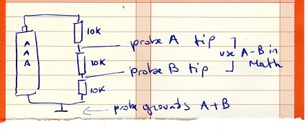

    0 Jan Cumps over 7 years ago in reply to jw0752
    Use this on a low power board, John image
    Maybe a AAA battery with 3 series resistors over it.
    Try to measure the voltage over the middle resistor.
    Your Rigol has the function.
    • Reject Answer
