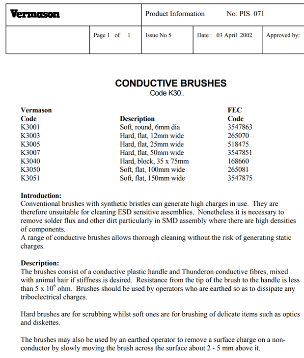

    It is a very stiff, and is anti-static. The stiffness helps with scrubbing the board with flux remover, especially near SMD parts. Also, it will give you many years of use - I've used mine for a long time.
    The links are for the 12mm version, which is the one I use, but if you want to buy several, then they come in several widths, check the list below for the 'hard flat' entries.
    The current price (£8.75 UK) is actually pretty good, it has been a lot more expensive in the past.

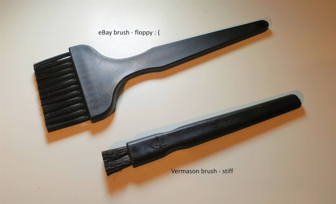

    The photo below shows my Vermason brush which I purchased maybe 10 years ago! although it hasn't seen heavy use, it's still looking good. The ebay one looks like new because I've not been able to use it : ( it's as soft as a paintbrush.
