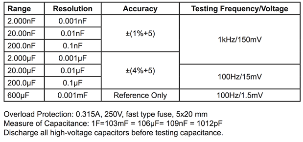

    Looking at the manual for this, it indicates that there is fuse protection on the circuit, have you verified that this is ok?
    It also gives a specification of the output for these tests, do you have a frequency counter or oscilloscope that you could use to see if the test output is within specification?
