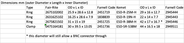

    It's a bit off-topic for the original post but I think I've got it, so for anyone else who reads this.  By design or by accident, Shabaz has a range of ferrites of varying inner diameters and two materials: Nickel-Zinc (Ni-Zn) and Manganese-Zinc (Mn-Zn).  These materials are useful for different frequency ranges (see image below.)  Manufacturers use different codes to represent these materials: in terms of the parts that Shabaz references, Fair-Rite use 31 and 75 and Kemet use 700L and 5H; there are other codes as well to cover different ranges and the link I posted above gives a good description with reference to Fair-Rite codes.  I couldn't work out what other manufacturers such as Wurth or TDK use.  A good representation of this is in this image from a Kemet datasheet:
    So one could obtain a variety of ferrites of different materials and different inner diameters to cover a range of frequencies.  As a reference, here is a x-ref of Fair-Rite products and Kemet equivalents:
    Hope this is useful.

    0 shabaz over 5 years ago in reply to Andrew J
    Hi Andrew,
    Unfortunately I don't know of a UK source, as you say that cost can be prohibitive, I waited until there were several things I needed so that the £16 charge didn't feel as bad as it does!
    Also, as you mention in your comment, the material type determines its usable frequency, sometimes there's no need to know the type but depends on the datasheet quality - Wurth and others have a plot, whereas other manufacturers might just indicate the impedance at a few frequencies, both of which can be usable, but others may not have even that. Down at the low frequencies (say 100kHz or 1 MHz) none of them offer as much impedance as might be desired, so it can be useful to loop the wire through a few times, or stack several ferrites on the wire, if you're interested in suppressing noise at these frequencies. Once you're into the tens of MHz or beyond, then there's a bit more choice, e.g. type 43 material is fine for tens of MHz to VHF, type 61 for VHF to 1 GHz etc. But for your noise measurements you're more interested in the lower range.
