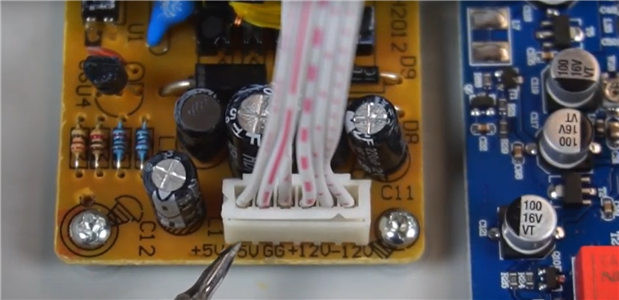

    thank you.  Ironically enough, having just rec'd a KKMOON FY6900 (FeelTech clone), the SMPS has the following outputs +/-5V, G, G, and +/-12V.  However, only the +5V is used, running a +5V and ground wire to the main board.  The +/-12V is not used.
    I'm purchasing a better quality SMPS  PMC Panel Mount Power Supply 5V 15W 1 Phase / PMC-05V015W1AA from Mouser, 40mm fan, and adding an inline fuse on line from AC input.  Also, replacing the thin (22gauge?) wires from AC to SMPS with 16 gauge wires.  thanks for all the great feedback.  I understand the FY6900 is a cheap Chinese device, but I am just getting into this "hobby" so it's a learning aid.
    • Reject Answer
    0 shabaz over 5 years ago in reply to cdpar2000
    Hi Charles,
    That's unusual, there's a FY6900 video where the connections are made to all the supply rails:
    I think it's likely for a signal generator to have multiple rails, so if yours is not using them, that's surprising.

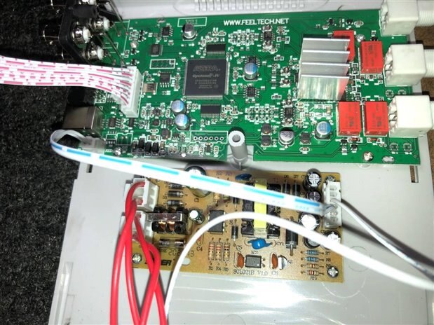

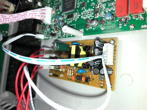

  • cdpar2000
    0 cdpar2000 over 5 years ago in reply to shabaz
    Yes, it appears this is a different rev board.  you can see, on the PCA, the location of a 6-pin connector, no connector on board.  the single wire goes to the AC ground spade.  Also, it appears the earth ground wire is connected to the negative wire going to the main board as I verified with continuity.  I'm purchasing a better quality SMPS  PMC Panel Mount Power Supply 5V 15W 1 Phase / PMC-05V015W1AA from Mouser, 40mm fan, and adding an inline fuse on line from AC input.  Also, replacing the thin (22gauge?) wires from AC to SMPS with 16 gauge wires.
    • Reject Answer
  • hlipka
    0 hlipka over 5 years ago in reply to cdpar2000
    This is indeed quite strange, because without the +/- 12V, the generator cannot output its specified voltage (which is, IIRC, +-10V sine wave). If it does output this voltage, then there would need to be a boost converter on the main board.
