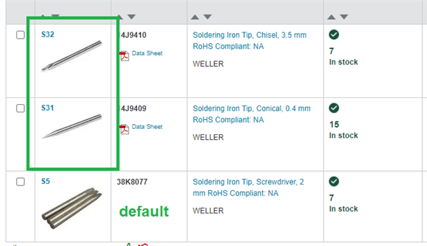

    0 hugohu over 5 years ago in reply to Jan Cumps
    https://www.newark.com/c/tools-production-supplies/soldering-stations-accessories/soldering-irons/soldering-iron-tips-nozzles?brand=weller&for-use-with=sp15lsi15-soldering-iron
    I think these would work, but I wouldn't be sure.
    I have a SP25 and the tips are screwed on(the tip is literally a screw, kinda), and the SP15 is likely similar... The images at newark show a flat barrel

    0 Jan Cumps over 5 years ago in reply to hugohu
    Yes, the first 2 are listed on the SP15NUSSP15NUS as compatible. The last one is the model that's fitted on that iron when you buy it.

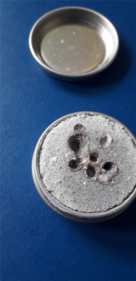

    A little watch-out with that second product. It's not intended for regular use.
    It has rather active flux in it, and is made to clean tip areas that can no longer be wetted.
    a speedy and effective product for cleaning and re-tinning de-wetted soldering irons that cannot be re-tinned by sponges, pads or rosin-cored solder wire
    A great product, but should be used when needed, iron has to be allowed to stay hot long enough ( > 220°) to ensure all active product burns off, and the tip has to be cleaned and re-tinned with normal solder afterwards.
    I'm using a Weller branded product, called Tip Activator, that according to the specs rumours is more corrosive than the Henkel paste in your little container:
