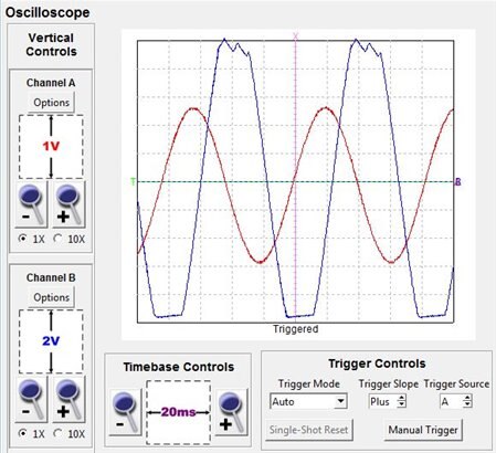

    0 JRR over 15 years ago in reply to michaelkellett
    Michael, all,
    I received the Pyle 15W per channel amplifier.  I conneted it up to the function generator and oscilloscope combo, and started testing it.  I found out the following:
    1. If I went below 10Hz, it would not amplify as well, and it would only reproduce square waves correctly above 20Hz.  Makes sense since the amplifier's frequency response is 20Hz-20kHz I believe.  The LME89430 in the module's specification for frequency response starts at 1Hz.
    2. The Voltage is limited to 10V for the 15W amplifier.  This seems to be because of a constrain with the speaker resistance of 8ohm.  Based on this the next point. (I could post the scopes screenshots if anybody is interested).

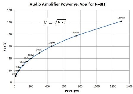

    3. I made a graph to see what sort of pre-made audio amplifier I would have to buy to reach my wanted Voltage based on the 8ohm impedance/resistance, and it didn't make me very positive about buying a high W amplifier, because it seems they mostly have this 8ohm restriction.  See graph below:
    According to this graph I made, it seems I would need a 1300W amplifier.  Maybe this safety limiting factor can be removed from the module (which seems to have it as well).  Or I might be totally wrong here as well?
    4. I contacted the person with the LME89430 module and asked a few questions til I bored him.  He said his module should work, although now that I went to the specs again, it seems to also have the limiting voltage because of the 8ohm speaker protection.  If this is the case for the modules as well, can they be modified to change this restriction?

  • RWM
    0 RWM over 15 years ago in reply to JRR
    As you have stated in first post:
    - Resistance has ranges between (given by my material and my electrode geometry)
      1. Wet = 10kOhm
      2. Semiwet = 100kOhm
    So you don't need 1300W amplifier because you will have load resistance 10kOhm minimum, but you need Vpp 100V. As your load resistance is over 1000 times higher than 8 ohm, you need not such high output current which is needed for 8ohm. You need power amplifier with LME and output transistos which can withstand over 100V of source-drain voltage. Amplifier stated in fourth post http://www.audiomodule.com/amp37.html is good as it has 200V IRFP240/9240 transistors.
    Power limitations and protections are valid for 8 ohm load, in your case (10 kohm) output current and power  should be over 1000 times lower than for 8 ohm.
    As to low frequency limitations, you should change input and loop capacitors to 20 times bigger or remove them. If I would have schematic, I could point them.
  • JRR
    0 JRR over 15 years ago in reply to RWM
    RWM,
    Yes, that is why my 15W amplifier should work, but it doesn't.  It will not go over 10V.  I am running the amplified signal over a 1000ohm load, and the maximum voltage I can get is 10Vpp.  Here is the graph of my signals (original in red, amplified in blue) at 12Hz, and then the same signal when I crank the volume up on the amplifier.  Look at how it finds a ceiling and floor at +/- 10V.  My input is about a Vpp = 5.4V, and the output of the 15W amplifier can reach 10Vpp without distrotion, but, if I try to get more out of it, I get the image on the right, where the voltage never exceeds 10Vpp.  if you continue, you just get sort of a square wave that does not exceed that 10Vpp limit.  If it wasn't for this, my 15W, US$20 would be more than enough.  At 10kOhm, 1W would be enough to drive 100Vpp.
