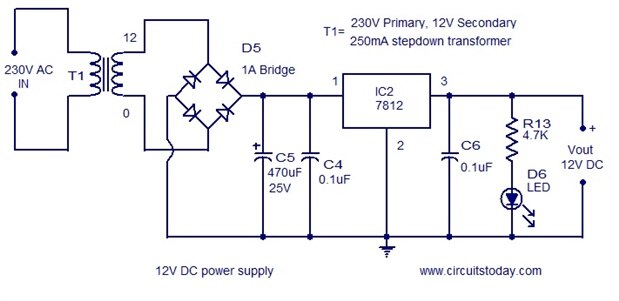

I am new to the forums and new to electronics. I am an apprentice Electrical engineer in my 2nd year and I quite fancy getting into electronics and start working more with my raspberry pi but firstly the I want to get the basic stuff down. I already have a few bits of kit and I recently bought some more stuff to build a little power supply for 12V and I am following this drawing....
I Got all of these exact components but the issue that I am having is that the output is 17V DC but the output from the transformer is 14V AC does anyone have idea what I may be doing wrong or how I could fix this issue?

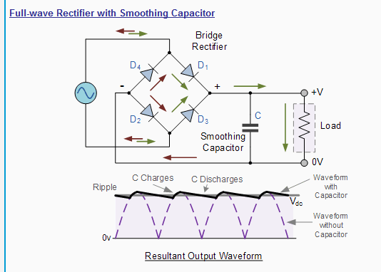

    That is the correct voltage to expect when using a full wave bridge rectifier.

    You need to add a capacitor on the output, and a good rule of thumb is 1000uF per Amp.
    This is the absolute minimum so I suggest 4700 (along with the 0.1uF). based on your 250mA transformer.
    However things tend to get replaced (ie the transformer), and to be safe a 10,000uF cap might be a better option.
    You are fortunate that the rectified voltage is 17, since the LM7812 (and most 3 terminal regulators) have a 2.5v internal drop (it varies between manufacturers), meaning that the input voltage needs to be 2.5v higher than the output.
    Therefore in your case the minimum is 12 + 2.5 = 14.5v DC.

    Where are you measuring 17V?  If it's at the input of the regulator (IC2 pin 1), it's probably right.  From the Wikipedia link, 12V RMS is 17V peak, so if the LED is the only load you'll see 17V at IC2 pin 1.  However, as you add load at Vout, the ripple at IC2 pin 1 will increase and its average will start to go down.  At some point the low end of the ripple will go below 14.5V and you'll start to see ripple at Vout.  This is hard to observe with a multimeter -- it's much clearer what's going on with an oscilloscope.
    If you're seeing 17V at Vout (IC2 pin 3), something is wrong.  Either you have a bad regulator, something is wired wrong, or the small value of C6 is screwing up regulator function.

    0 e14 Contributor over 12 years ago in reply to johnbeetem
    I See 18V out of the rectifier and 17V at where it says 12Vout
    i added a small 555 Circuit to the Vout and the voltages don't really change. Also the regulator gets really hot. I will maybe try changing C6.

    The regulator should not be getting hot with just the LED as its load.  That's only 3 mA through through IC2, or 3 mW with a 1V drop.  So something nasty is going on.  I'd try (1) disconnect everything from IC2 pin 3 and see what you get, (2) see what you get with just C6, (3) see what you get with C6 plus whatever 25V cap you have handy that's at least 1 uF.
    Oh, do make sure all your caps are rated for the voltages.
    Thanks for your help everyone but i figured it out! I check the pins for the IC and i had it the wrong way round! Thats what happens when you build these things when tired. and a bit of a noob thing really. but thanks for your help.
