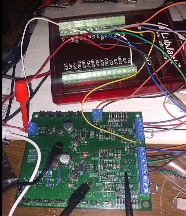

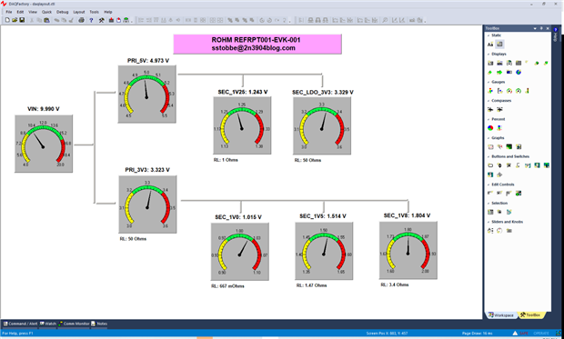

I wanted to put together a quick demo for an upcoming Roadtest. I used a software application called DAQFactory (https://www.azeotech.com/j/index.php ), mainly because it is simple to use and supports the old labjack U12.
After I tidy up the wiring, I can take photo/video of the DUT and live measurement data in the same frame. I have seen other members use a picture-in-picture live view of the DUT, which I think is pretty snazzy! Sometime I will try that too.

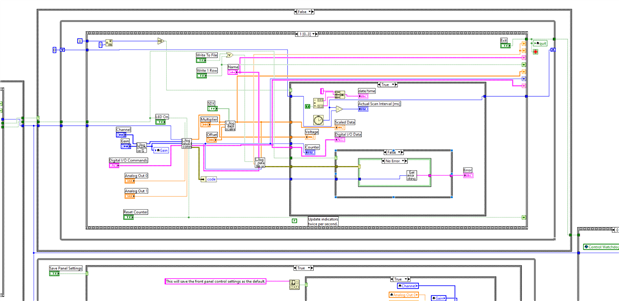

    I did end up downloading the free Labview Community Edition. It worked right out of the box as you would expect from a NI product. I was able to run some of the old labjack Labview demos too.
    I haven't used Labview in a very long time, I'm not sure what's changed. The sample labjack Labview VI's are exactly like what I remember Labview to be.
    For me personally, graphical programing is 10 times harder than just writing a Matlab/Python script.
    Hopefully, there are some simpler and cleaner examples with this Labview release.

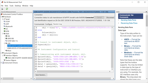

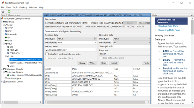

    I don't know of any other general-purpose blocks-based system with the rich support for instruments, but for a non-blocks alternative then I'd probably use Python too nowadays. Although having said that, I used MATLAB yesterday, it is quick and convenient if it's installed. It has an 'Instrument Control Toolbox' option with a form that will convert entries into code.
    Here is where you can type up your queries, and it builds up a list of what you did.
    Then, you can click on the 'Session Log' tab to see what MATLAB commands it translated to:
    It is then possible to copy-paste that into functions or directly execute in the command prompt or add in your logic in code and so on, and a couple of clicks to chart stuff (a for loop would need to be written to capture, then click to chart it, or MATLAB code can be written to chart dynamically as the data arrives).

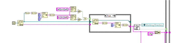

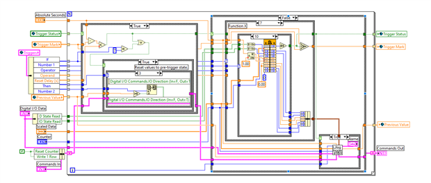

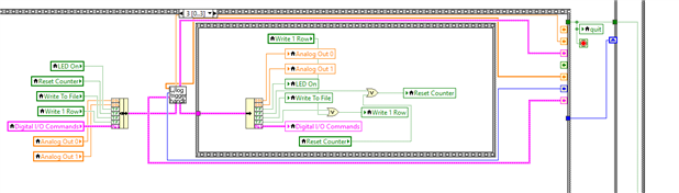

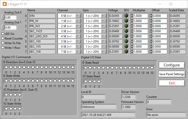

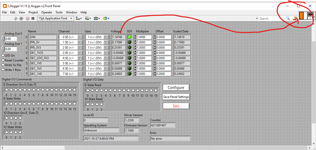

    I think I am going to take the time and tinker/relearn Labview. I think its going to take a long time to get everything up and running. But once it is setup I think I will be able to put together a live readout display very quickly and easily. Slowly some of the Labview details are coming back to me, such as the use of hieratical VI. So, I can modify the sample labjack demo just to output the voltage readings on a block terminal:
    It doesn't work just yet, but hopefully it will be just this easy eventually:
