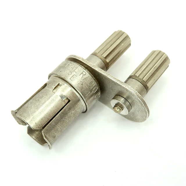

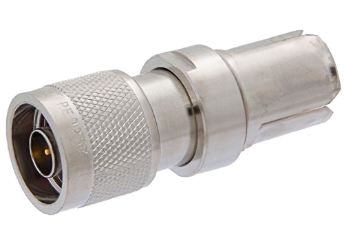

    Nice assortment. I also have some GR connectors like this one They are good from DC to 9 GHz find more info here ~~Cris

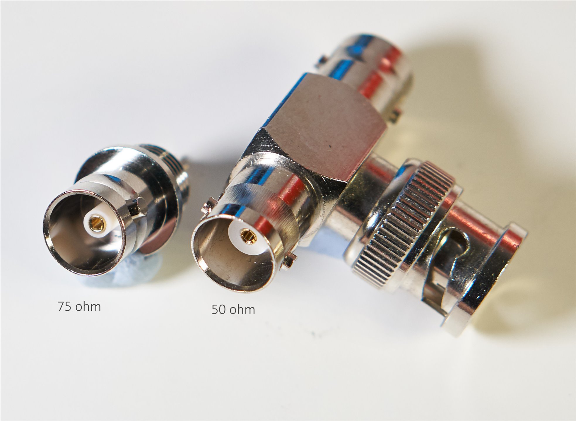

    BTW BNC comes in both flavors 50 & 75 ohms You have to check the pns ~~Cris

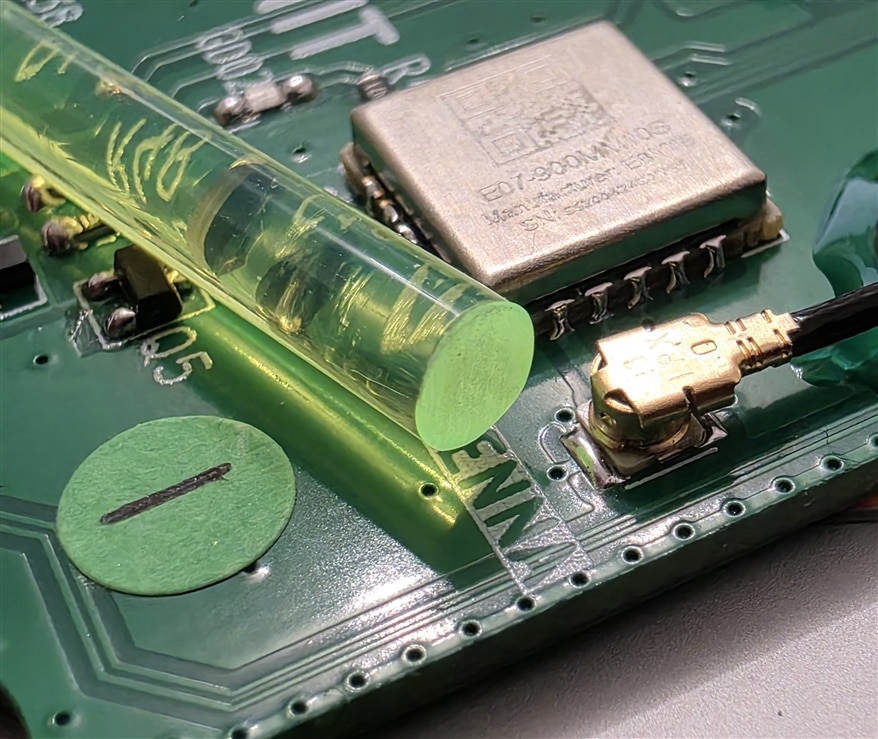

    Nice assortment! I prefer SMA antennas and recently got some u.FL to SMA cables.. but I need to improve using those, I find it very difficult to keep the u.FL connector aligned while pushing until it snaps in. I have tried using round bar, since then I can keep that vertical, I just about manage. Might try to make a tool one day, or buy something (don't want to spend a lot since I don't plug so many in!).
    Jan Cumps 3 months ago in reply to shabaz
    I have a trick. The first time I tried one, it embedded itself under the skin of my thumb Disappointed.
    But if you align it over the connector by holding the coax cable between thumb and index finger, just in the right position (and with your tongue in the right angle), you can press it down and it snaps in.
    shabaz 2 months ago in reply to Jan Cumps
    I gave that a shot!! You're absolutely right, the trick is to hold and look at the coax, and make sure it is parallel to the board. For the snapping-in, I still didn't trust myself, so I ended up finding a short length (about 50mm) of acrylic rod, and pushed with that (it was easy to see that the rod was vertical) although I guess there is a risk it could slide off while pushing. Might place a few-$ order for a 3D-printed tool with any next PCB order.

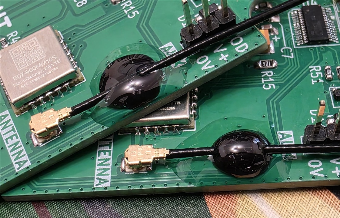

    Incidentally, I was also wondering how to make it more permanent, because I won't be around when this board is installed in an enclosure, it is for a friend to fit in their garden watering "system". They would not know how to re-snap that connector in, if it worked loose.
    The experiment for now (I'm not very happy with it) was to add some strain relief to the coax. I used a small blob of black polydoh, and pressed in the coax to form a cradle to support the wire. Polydoh isn't adhesive, the cradle would slide around, so then I placed a few drops of UV glue on top, and cured that.
    I might go back and put some other glue onto the connector itself, but I'm unsure since it might seep inside it. Maybe it's already fine. I also still need to add a coating to the board, since it will be outdoors.

    I'm more of a glue gun kind of guy, but I guess there are reasons not to use that in such a situation .
    shabaz 2 months ago in reply to obones
    Not a bad idea, since that won't drip inside the connector : )

    Perhaps a couple of holes through the PCB and a thin cable tie or loop of tinned copper wire through them and around the back of the connector ?
    Could do similar with the cable instead of the Polydoh/UV glue..
