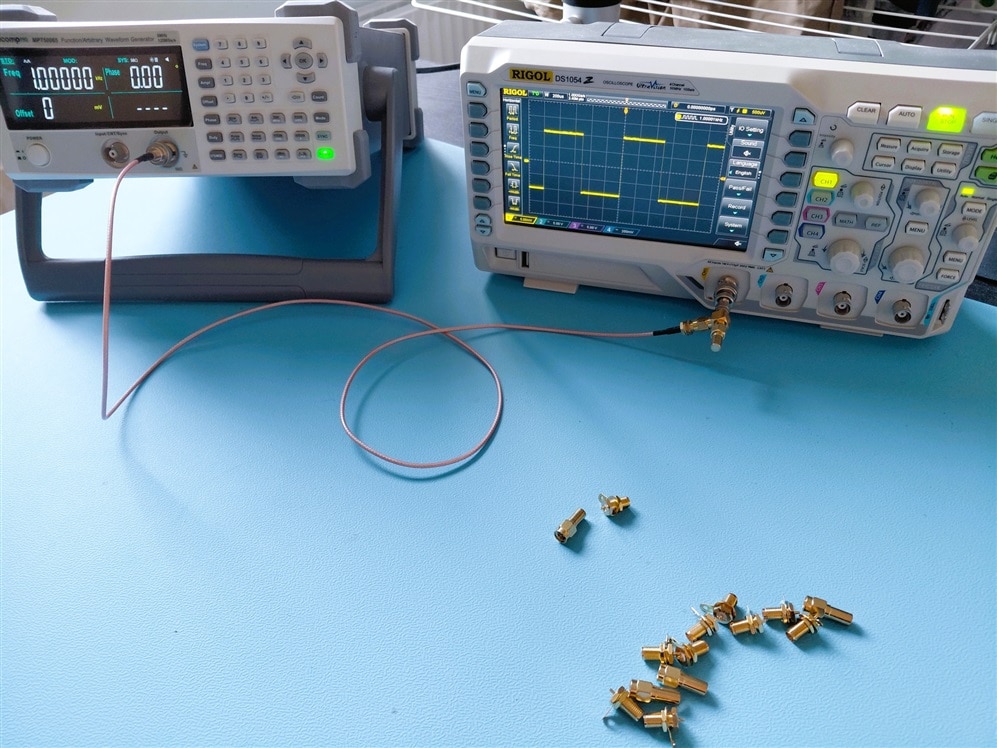

    Jan Cumps 3 months ago +4
    I got some SMA components recently. To check which ones I can use best for measurements. A few T-adapters, BNC to SMA adapters, a bit of 50 Ohm cable, 50 Ohm terminators.
    shabaz 3 months ago in reply to Jan Cumps
    Nice assortment! I prefer SMA antennas and recently got some u.FL to SMA cables.. but I need to improve using those, I find it very difficult to keep the u.FL connector aligned while pushing until it snaps in. I have tried using round bar, since then I can keep that vertical, I just about manage. Might try to make a tool one day, or buy something (don't want to spend a lot since I don't plug so many in!).
