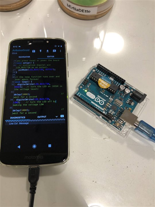

    Update: I was able to program an Arduino Uno from my Android phone!
    I used Anton Smirnov's app ArduinoDroid, and it seems fairly straightforward to use. I haven't put it through any difficult tasks yet but the basics went without any hiccups.
    Upload can be done via USB-OTG, as I did, but also via WiFi (not sure how that works yet... might be an ESP-8266/32 thing).
    Here are some screenshots:
    All I did was connect the usual Arduino USB cable to the USB-OTG adapter. The Arduino gets powered by the phone, but the draw doesn't seem too terrible. I didn't use it for very long, but I also imagine it would stay unplugged while doing the coding.
    Arduino from Android
    On this phone the code editor is tight, but not impossible. I imagine it would be much nicer on a tablet:

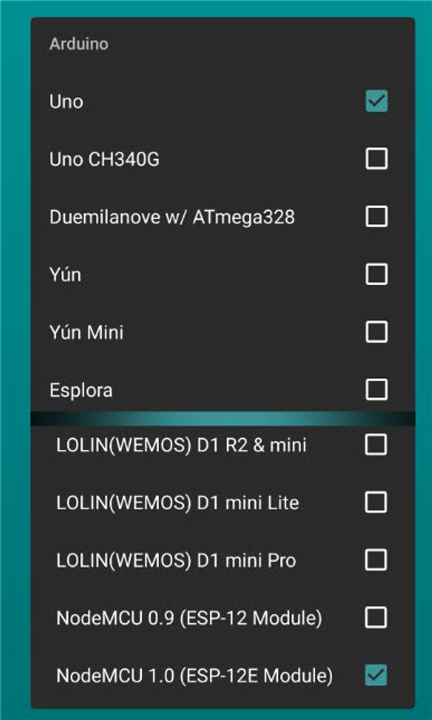

    Nice that it supports my favourites right out of the box - the Uno and the Wemos D1 R2 Slight smile
    Android Arduino supported boards
